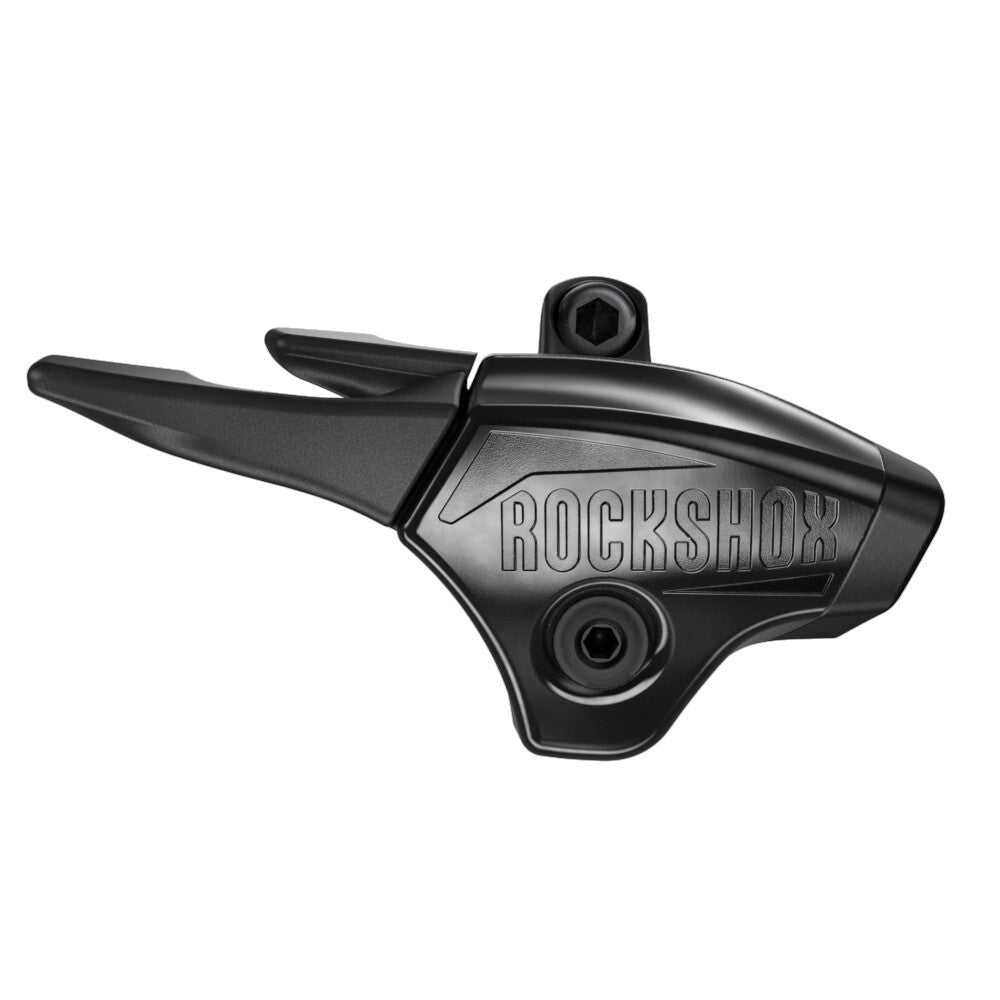

Just picked up some OEM Fox 32 performance forks. It comes with the top cap for a remote lockout but alas no actual lockout lever. Looks like Merlin had them for £25, but sold out now and the only places with any stock seem to want a fortune for them. Wondering if anyone knows of other levers that can be used instead? There's a cheapy one on Amazon which I may try but I'm skeptical that it'll work.

(You'll want to check this but) I thought the Fox lockout lever cable pull was 10mm. If so it is the same as a current 2 position Rockshox lock out lever (or twist grip).

I'm using a Rockshox remote on a Fox rear shock having done some googling and come to the same conclusion that they use the same cable pull, as the Rockshox remote has a double outlet for Fork/Shock it should therefore pull the same amount of cable for both.
Sorry I can't be 100% confident as I haven't tried it on a Fox fork myself but for £25 I'd probably have a go. I've used this lever:
https://sportandleisure.com/products/rockshox-oneloc-remote-lever?variant=53264283140483&country=GB&currency=GBP&utm_medium=product_sync&utm_source=google&utm_content=sag_organic&utm_campaign=sag_organic&gad_source=1&gad_campaignid=23014340359&gbraid=0AAAAADKtyDB2IYjeOEiKW19_2-AnkGo_V&gclid=EAIaIQobChMIltzr87umkAMVh5NQBh1gPgEIEAQYASABEgK79PD_BwE

Thanks jfab - that backs up what letmetalktomark reckons. I just checked the ebay listing for the forks and it actually states: "Remote Compatibility: 10mm cable pull (e.g., FOX or RockShox remote, sold separately)", so that's pretty conclusive.s

I'll try the rockshox one first. Might need to get creative with fitting that and a dropper post lever on the same side of the bar 🙂

It’s a little curve ball but on a current build I tried a Rockshox Pushloc ^^ a la the one above on the right under the bar next to the shifter. It worked fine but the aesthetics drove me potty!
I’ve since gone with a 2 position Rockshox Twistloc on the left and the dropper lever sits neatly below.
The two position Twistloc again pulls 10mm.

From what I've read it's a whole new damper assembly. I finally tracked down an official 3 position fox lever on eBay for just over £30, so have gone for that. Link if anyone else is on the hunt: https://ebay.us/m/BekaoM
The cheap Amazon/eBay lever didn't work too well. It only seems to have about 6 or 7mm of cable pull.
