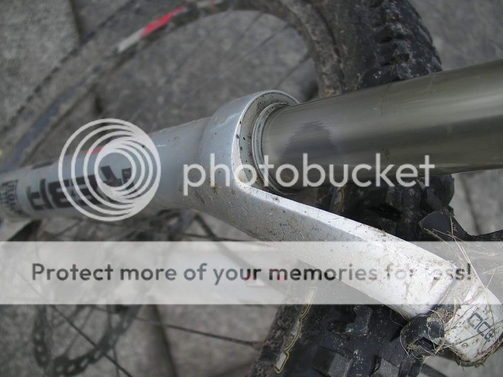

I do think its odd how I have racked up several thousand miles on motorcycles (off road) and it has never occured to me to look at fork servecing or stanction wear on motorcycles.
Why cant mountain bikes have the same level of durability?
light weight/performance should not come at the expense of reliability imho. 😥
Some Rockshocks yesterday
Posted : 18/02/2010 9:30 pm
