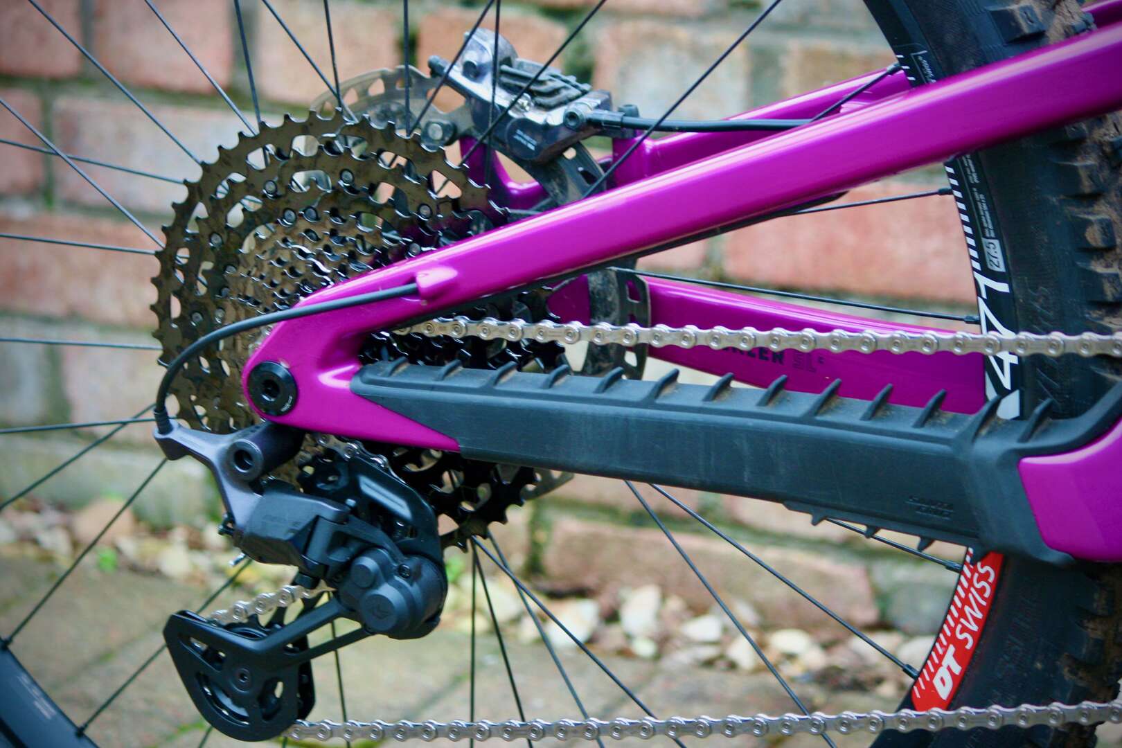

Posts: 3891
Compared to 12sp XT, the only downside I've found with 11sp LinkGlide XT is the lack of multi-release shifting: one press of the shifter allowing a single downshift only, compared to multiple with 12sp XT. Otherwise the shifting feels as good as 12sp XT so far.
Posted : 25/03/2026 8:34 am

Posts: 3891
Posted by: mert
I can see why, gear dumping under load, with an extra how ever many Nm of torque added isn't going to do your chain or cassette any good!
Posted by: kelvin
Single cog shifting is in there for ebike use... to try and safe you from mashing the cassette.
Oh I know the reasoning and it's definitely sensible. Totally a "me" thing in how I use a 12sp shifter it seems, so I'm wrong to call it a downside.
With 12sp multi-release it seems I depress the shifter slightly for a single, first downshift. But then, rather than release my thumb from the shift lever, it appears I keep it depressed for a few seconds before depressing it further for the next downshift. I wasn't aware I was doing that until first ride with 11sp LinkGlide and wondered why it wouldn't downshift! I've been spoilt with years of multi-release 11/12sp XT/XTR shifters it seems.
Posted : 25/03/2026 9:59 am

I put a cheap shimano 10 speed 11-42t cassette + chain on mine.
This one -> https://www.wolfcycles.co.uk/product/shimano-deore-cs-m4100-10-10-speed-11-42/
I used the existing shimano 12 speed mech (mechanically identical to 10 11 speed these days), with a 10 speed shifter. I think its done 1500 miles now.
I never clean or wax the chain, i just put a load of oil on top of the mud.
Bosch CX powered Canyon Stive on fwiw. I used to use the 51t tooth to climb up stuff, but its fine in the 42t. Only thing is you can't climb anything with motor off but its got DH tyres on anyway, I've got an XC bike for that sort of thing.

Posts: 1779
Posted by: stevede
No dramas with the deore 10 speed mech on 11 speed and the cage is a bit shorter meaning it’s less vulnerable to getting smashed. Cues shifter feels a bit cheapo but does the job if you can’t stretch to the xt.
Is that the GS cage (med cage) Deore 10spd mech? With which cassette?
Posted : 27/03/2026 7:55 am
Posts: 14139
Is that the GS cage (med cage) Deore 10spd mech? With which cassette?”
It’s the LinkGlide Deore mech - I think there’s only one version. And that’ll work with any LinkGlide cassette as long as it’s not more than 10 sprockets and 43t biggest.
Posted : 27/03/2026 11:22 am

Posts: 1779
Posted by: chiefgrooveguru
I'm interested to hear if anyone has used it with a 45+ tooth. There's usually a difference between the specified max & in-use max that people run without issues (Zee & Saint mechs for instance).
