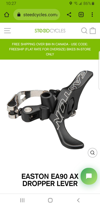

Easton do a drop bar specific remote
I am (literally) about to fit one of the those Easton remotes...
Also, if you're running 1x but have a 2x left shifter to you can actually butcher the internals to remove the ratchet, then use the left shifter as the dropper control.
Note: I haven't done it but, randomly, I watched a You Tube video last night showing how it's done
