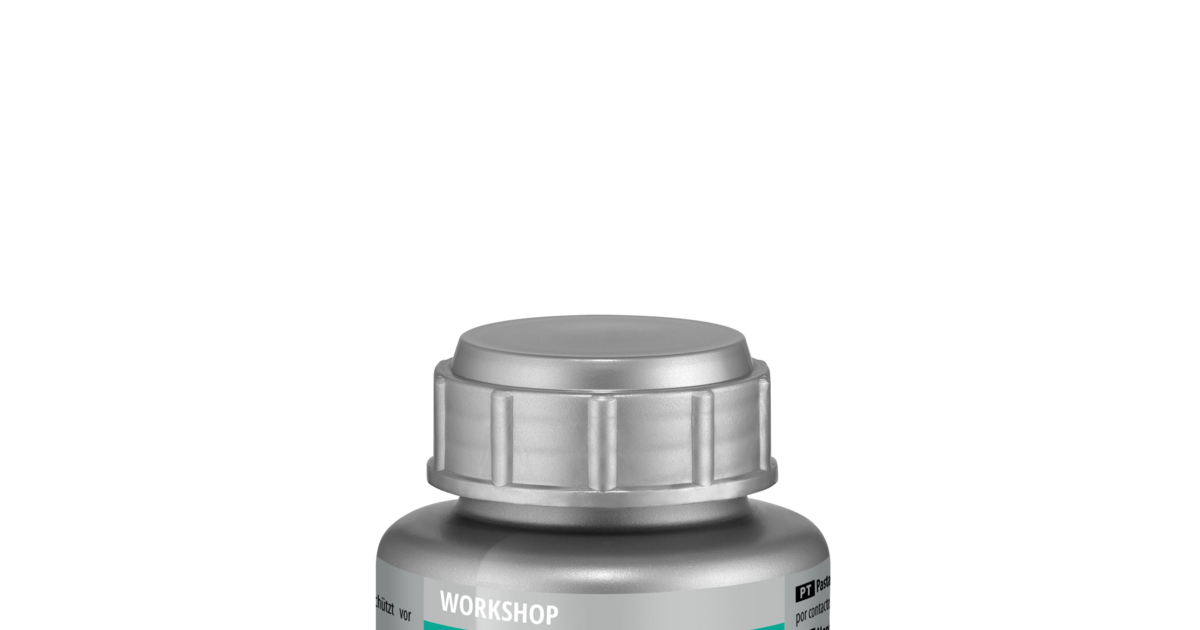

I recommend Motorex Carbon Paste for anything near to moving parts, e.g. headsets and droppers, it doesn't have the "gritty" bits.
You can use a plain grease, but that isn't so good on a seat post subject to a battering (not a personal comment, BTW 😉 )
http://motorex.com/en-us/carbon-paste--13360
