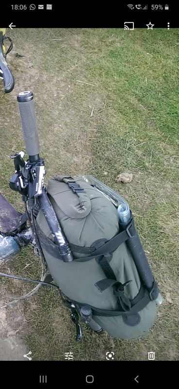

It's difficult to swop bars between flat and drops as drops require brifters for the hood position. Road brakes and shifters are expensive especially if you go hydraulic. If you want drops, just stick with them but experiment with wider or flared. For me, they don't work off road.
@Malvern Rider set up is the way to experiment with different bars, remember to keep your cables long!
Put a wanted add up for bars, I'm sure one of us have a set of px copies for sale. A lot of people got excited on the psa and probably never fitted them! 🤣
I've tried salsa woodchippers (which I need to sell) and some Jones bars. I loved the idea of both of these but in reality you can't beat a riser bar and bar ends.
I can't find a better picture but this one kind of shows my set up. My j bend bar ends have a slot at the end for the straps to go through. I used to put my dry bag under the bad ends but I like it above now with a waterproof map book strapped to it. I use the j bar ends a lot when I'm on the road.
[url= https://i.postimg.cc/KjFSsqf4/Screenshot-20200527-180700-Photos.jp g" target="_blank">https://i.postimg.cc/KjFSsqf4/Screenshot-20200527-180700-Photos.jp g"/> [/img][/url]
