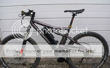

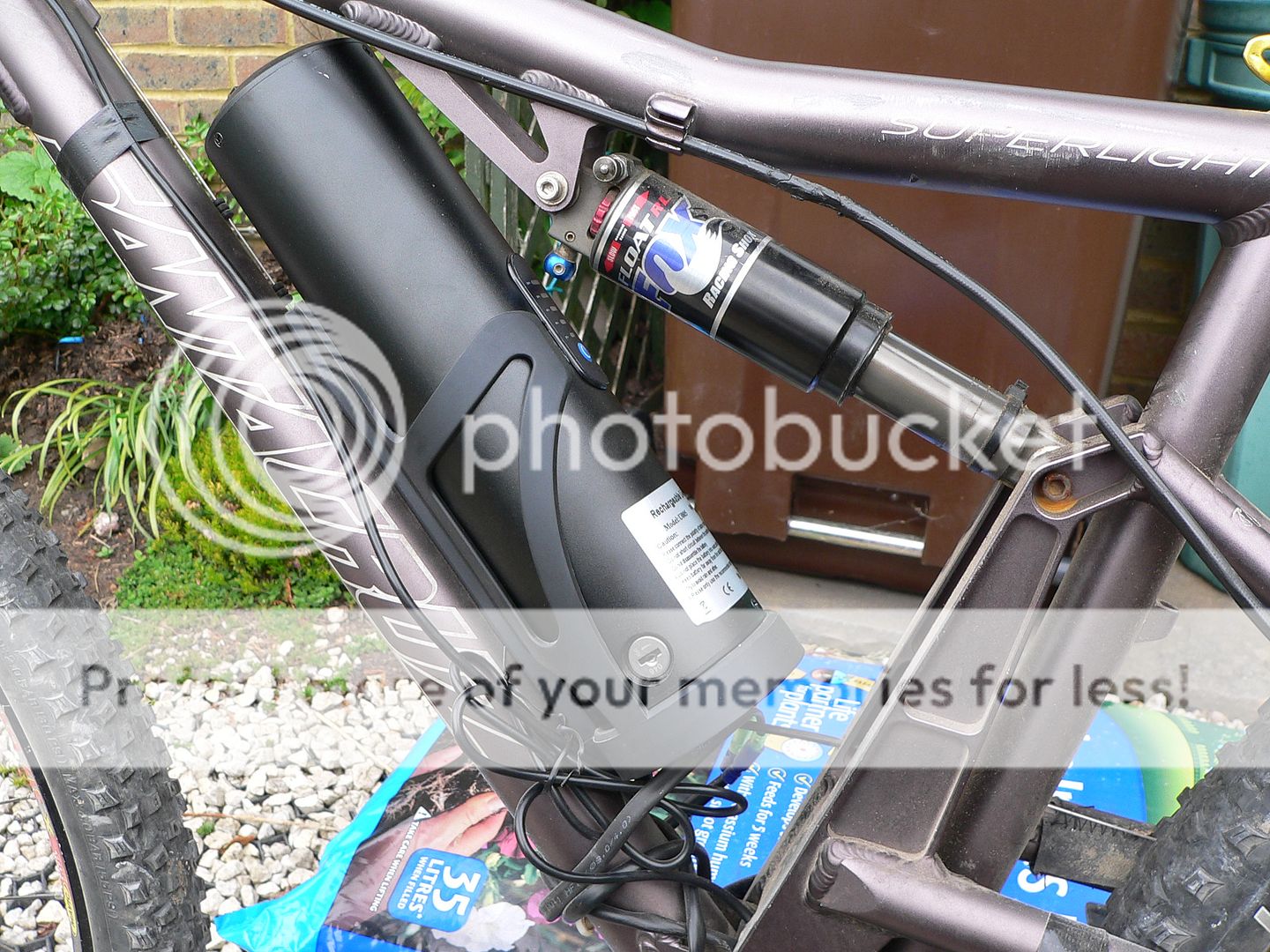

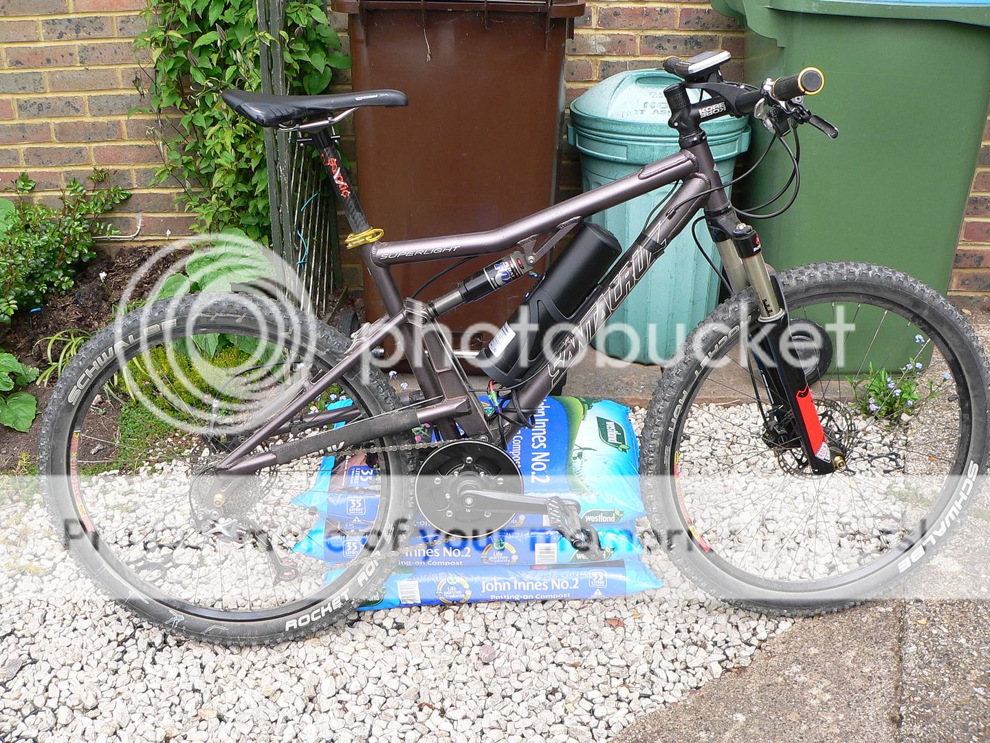

 rony
I recently converted a Santa Cruz Superlight using a TSDZ2 motor.Easy to do except the battery size and position took some thought and measuring.Largest battery that fits is a 11ah bottle carefully positioned to allow rear suspension to work.
More pics and info if anyone is interested.

rony - more pics and info please - I have an older Superlight and Heckler so interested how you achieved this.

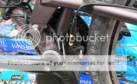

 rony
Superlight build.
250w TSDZ2 motor kit with vlcd5 controller £240
36v10.5ah Samsung celled bottle battery £200
Bafang crank arms £18
Braze-on adapter clamp £5
Stripped out cranks,bb and front derailleur
Fitted motor with clamp and steel rod as anti-rotation.Bit of a bodge but could not use rear stays to clamp.
Bafang cranks are for better Q factor.
Chain line seems fine with 9 speed cassette.
