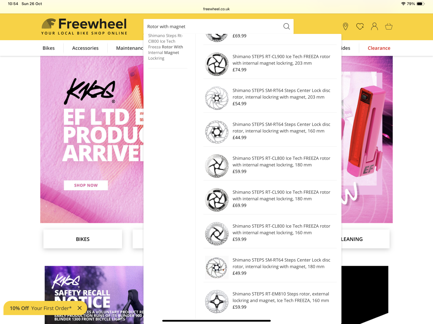

Posts: 3043
External lockring versions also available from www.freewheel.co.uk

Posts: 25927
Sorry, should've said.ย  The bike's sensor offset seems to be further than shimano's lockring or rotors seem to offer (and so I'm extrapolating that most others would be same).ย  Certainly the fancy Magura rotor on the existing wheel has what I assume is a hole for a magnet but it's too close to the axle and the cannondale adaptor doesn't match it
https://www.westbrookcycles.co.uk/cannondale_brake_rotor_magnet_adapter-42403?stockid=439147&gad_source=1&gad_campaignid=19642708299&gclid=CjwKCAjwjffHBhBuEiwAKMb8pFkrJ89TiCrIqi9BzW_r4PUqBPWO85l3JPek_4PKuCXc15QBYslnMRoCY68QAvD_BwE
