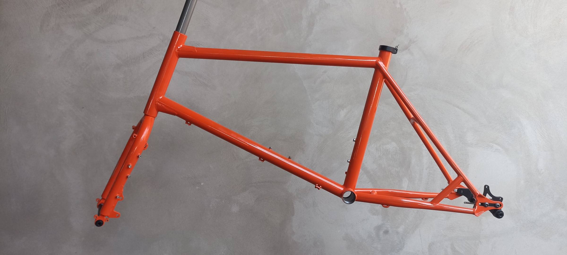

I've always had a thing for mini velos and owned a few too.
None have ever hit the mark geomnetry wise, so I'm going the custom route with Marino.
This will be a build thread as and when things develop and turn up.
It'll probably be dull and very niche..
So, a few key highlight:
- It's going to be Reynolds 520 frame with 4130 fork. I've opted for fender mounts & gravel mounts on the fork.
- The frame is exrternal routing but with a dropper port to run a 150-180mm ish dropper.
- Boost through axles front and read with sliding dropouts and clearance for 2.8" tyres.
Anyway, here's part 1-
The geometry I've settled for is this, Long/ low/ slack:
18584 - Kai Hodson - MINIVELO

@cokie, might want to check that fork length if you want to fit 2.8 tyres. A 20 x 2.8" tyre is about 280mm radius I think and a steel unicrown fork often has 35 to 40mm crown depth - so 282 to 287mm axle to underside of crown. Could be getting a bit close?
Posted : 31/10/2024 4:58 pm
Posts: 2599
Boom Boat
I love this thing. Looks great fun! I'm just not a fan of how it looks or the steep HA. Other than that it's spot on.
Marino quality
Yeah.. I've read lots about them, so fingers crossed! I didn't realise there was others on the market.
I'm locked in now, so let's see how this pans out!
Easy wheelies
Yup 😀 ! I loved that about my Zeta, so looking forward to the playfulness.. hopefully.
320mm A-C
You could be right.. I'm going to start with some Kenda Slant Six 2.6" which clear on other bikes with 320mm. Hopefully it'll be fine.
I'm locked in now, so no changing..
Posted : 31/10/2024 5:09 pm

So, I’ve named the project/bike.. Minimacho.
the decals just arrived. IMG_0221
Posted : 04/11/2024 6:16 pm

 image.jpeg Frameset now complete! 3-4 week wait on  shipping now.. gives me time to sort the drivetrain compatibility issue. Tempted to go Zee mech & 11-36t cassette instead.

So, here's the Minimacho!
All built up, completed a shakedown ride and a gravel 12 miler.
It's awesome! Very please with how it fells. Exactly how I thought it would.
Essentially a Stooge Speedbomb but more playful.
Doing some more rides and then editing together a little video.
It's not been smooth sailing with Marino... still seeing how it'll get resolved.

Posts: 12293

Posts: 17833
Looks amazing, although that rear mech looks very vulnerable so close to the ground.
Sorry for the ignorance, but is there a point to it, apart from 'just because'? Not that there's anything wrong with that, but just wondering whether it has a specific use case?
When working out your gearing for this type of bike, presumably you take into account the smaller wheels and the affect this has on final gearing?

Posts: 12293
Posted by: stumpy01
I hadn't noticed that, actually looks like the bottom jockey wheel might hit the tyre in first!

Posts: 3643
Great to see it finally built up. There is a Microshift clutch mech that is specially designed to give ground clearance with 20" wheels:
https://www.microshift.com/news/introducing-super-short/
I know it is hard to describe, but how does it steer?
I'm sensing a tale about the Marino experience - the "seeing how it gets resolved" sounds like something not being right.....

Posts: 2599
Cheers all! Trails are dusty so I've managed 28 miles so far and it's definitely smile inducing.
I've had a few mini velos and really like the playful handling. Also easier to move around for storage and transport in the car.
Primarily it's a 'just because' bike. They challenge you, especially offroad so makes some more mundane rides fun.
Yes, used a few gear calculators to work out what would work for me. I spend far too much time on a single speed, so this is a pretty luxuries gear range. For more urban riding I've got a 44t and some Schwalbe Super Moto 2.4"s.
It's close- about 15mm from the tyre in the granny gear. I've done 28 miles offroad now and no issues. Including a crash. I think the clutch makes a huge difference. I think the bigger issue will be mud in winter.
Long term I will go for MicroShift Advent though for peace of mind.
Really hard to describe- the geo is quite long and slack, like my speedbomb, so it feels familiar, equally it's really snappy due to the small wheels. At low speed it's fantastic to climb as I can pick my way up a gravel/rutted trails easily and it accelerate well, but I did a particularly rocky and descent that was terrifyingly fun(?). I've ridden it thousands of times on other MTBs- always off the brakes and pushing on. This is the first time I've had to brake. Wide bars help keep things straight, but with the small wheels and short back end it becomes more nervous and snappy the faster you go. Need to stay lose, especially with rocks and ruts pushing the wheel around. I'm getting used to the short chainstays too. Far to easy to over rotate and have a big off. Overall it requires far more delicacy with placing and steering.
Bits to change/adjust:
- Dropper post; I want more drop. When I'm messing around the saddle intrudes a bit. I think I can get away with 170mm.
- Bars: I've got a set of Stooge Junker 100mm rise bars- not 100% sure on riding position. Might find some low/mid rise BMX bars to try and get another 20-30mm rise.
