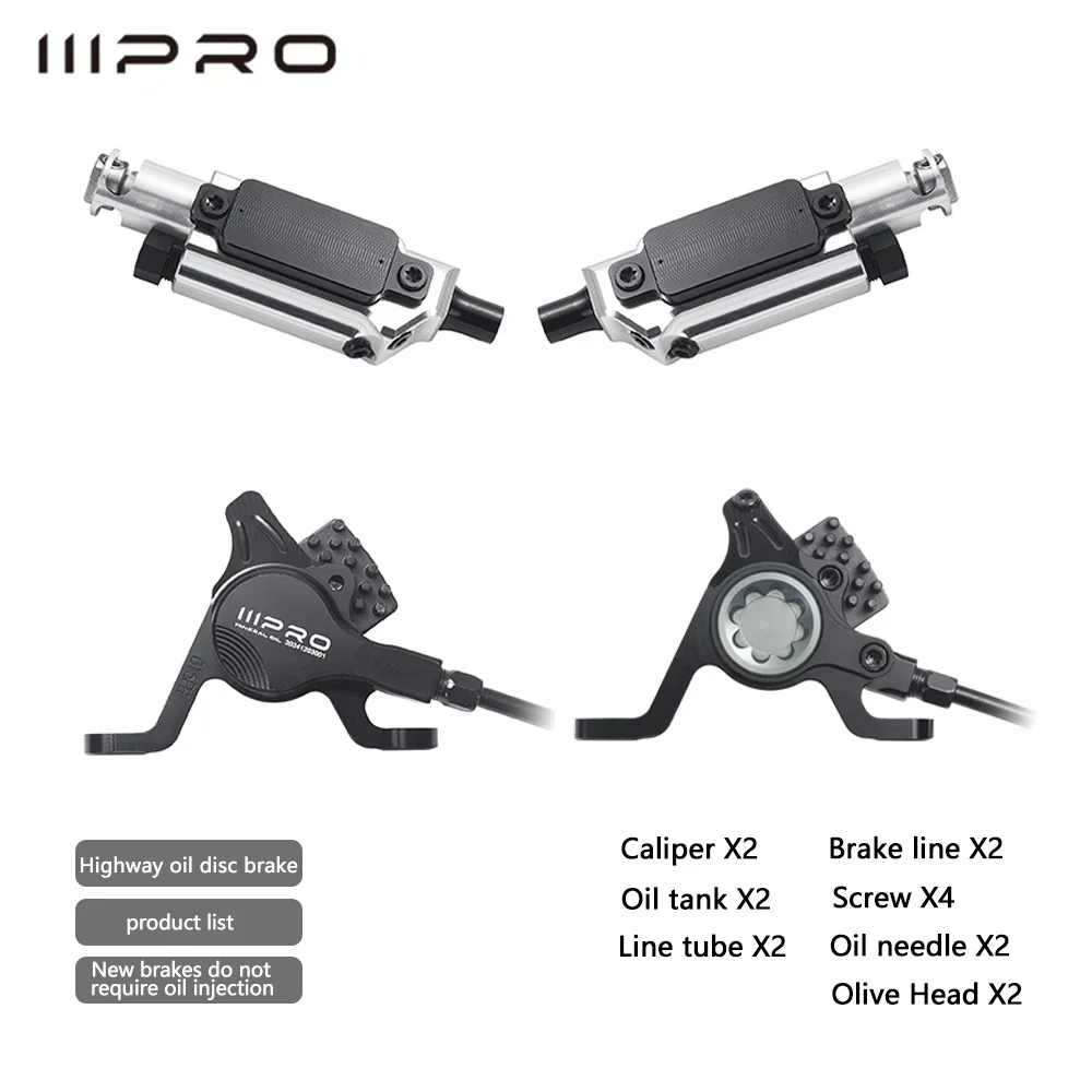

Don’t how to describe this but I’ve bought a kit off AliExpress (after seeing a video by Trace Velo). You basically use your existing shifter and cable brake lever with the cable going into a barrel that converts the cable pull into a hydraulic pressure with the brakes and hose supplied.
IIIPRO Bicycle mechanical line pull brake converted to hydraulic brake modified parts
https://a.aliexpress.com/_EQ50keE
Here’s a link to Trace Velo’s YouTube video and the item is at 11mins
Has anyone seen this or actually used it?

Juin Tech do a similar kit to do the same thing. I bought one a couple of years ago but then decided to buy another bike with hydraulic brakes, so my Juin Tech kit is un-opened/un-used!

I haven't used that particular set up by I did use the TRP HY/RD ones and they were pretty good, certainly better than any cable operated set ups that I have used but not quite as good as a full hydraulic system, but for the cost worth it in my opinion.
One thing to definitely do though is to use compression less outers, makes a difference.

I run Microshift SB-M110 levers on my monstercross, specifically designed to shift 1x11 Shimano MTB mechs across a wide range cassette, because gear compatibility across my bikes is my most important criteria. I like swapping stuff about. Contrary to some of the posts above, well set-up cable disks work fine.
I've always thought these hybrid cable/hydro setups are the worst of both worlds - all the friction associated with a long cable run, coupled with lack of serviceability, potential leaks etc in a hydraulic caliper. I also wonder how the latter deal with heat given there's less fluid in the system.

just fit decent inners/outers and prepare them properly. decent mechanical brakes are plenty good enough IMO. cable/hydros are the worst of both worlds. amazed they still exist.

I have juin tech on gravel bike it is about 7 years old now, daily commute and gravel use, they have been excellent. Have some on a road bike too. Not as good as full hydro but a lot lot better than cable disks.

They fix the main problem of mechanical disc brakes by not requiring regular adjustment as the pads wear down and are massively better than single piston mechanical callipers which come on cheap bikes.
