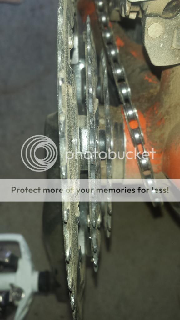

Here are some pics. You can see how much the chain ring sits proud of the tabs...
Also the second pic clearly shows a big difference in ring spacing...

No problem thanks for the reply.... I did just double check and the chain rings are definitely the right way round (the outer has a pin which lines up with the crank to stop chain getting stuck in the gap). Middle ring cannot go on the wrong way as shift ramps would be on the wrong side.
I know there would be slight differences between spacing of 9 and 10 speed chain rings but did not expect to be as much as 1-2mm or so.
The only thing I can think of maybe is that it's an early mega 9 speed Chainring. Always thought 9/10 speed rings were interchangeable but in my case it looks like not.
