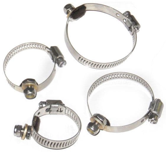

Posts: 15610
Task specific jubilee clip?
Would almost certainly have been my Dad's solution...

Posts: 14040
The thought of steel jubilee clips earing away at soft mg fork lowers makes me want to cry

Posts: 7210
The cheap cages from Planet X came with jubilee clips, didn’t fancy using them and cable ties did the job (wrapped the fork with a layer of amalgamating tape first).

Posts: 5054
A band of tape and then do them up TIGHT.
TBH I actually found they were a pain when proper off road as they just constantly caught on rocks, branches, bushes, heather etc.
