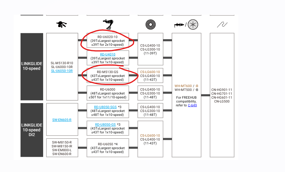

Posts: 73
if you buy the linkglide deore m5130 mech then its compatible with the cues shifter, the issue will be that Cues U6020 is meant for a 2x setup and the 5130 is for a 1x and has a clutch.
Cues mechs are discounted all over the place as well £37.99 at Bikeparts for example
