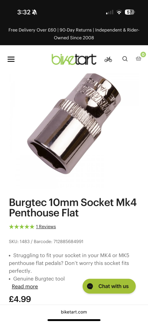

Looking to open/grease my burgtec pedals, but they need a specific 10mm socket with a thin wall to access the nut, and as I'm not in the UK, every seller either won't ship to me, or want insane postage (Burgtec themselves want ~£30 postage for a £4.99 socket)
Anyone know of a socket that does the job from amazon or similar? Tried a few but they're all too thick

Or that Biketart one 😀

Posts: 13857
Posted by: desperatebicycle
UK only, otherwise I'd have just bought it ages ago

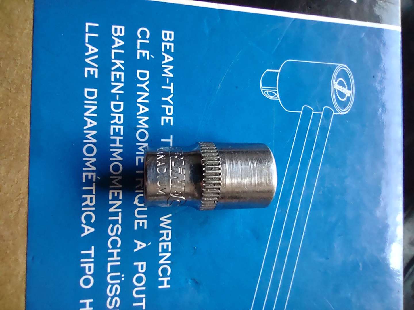

Posts: 17772
I've got a 1/4 drive 10mm Silverline socket that fits my MK4 pedals. IMG_20250826_160428736.jpg
