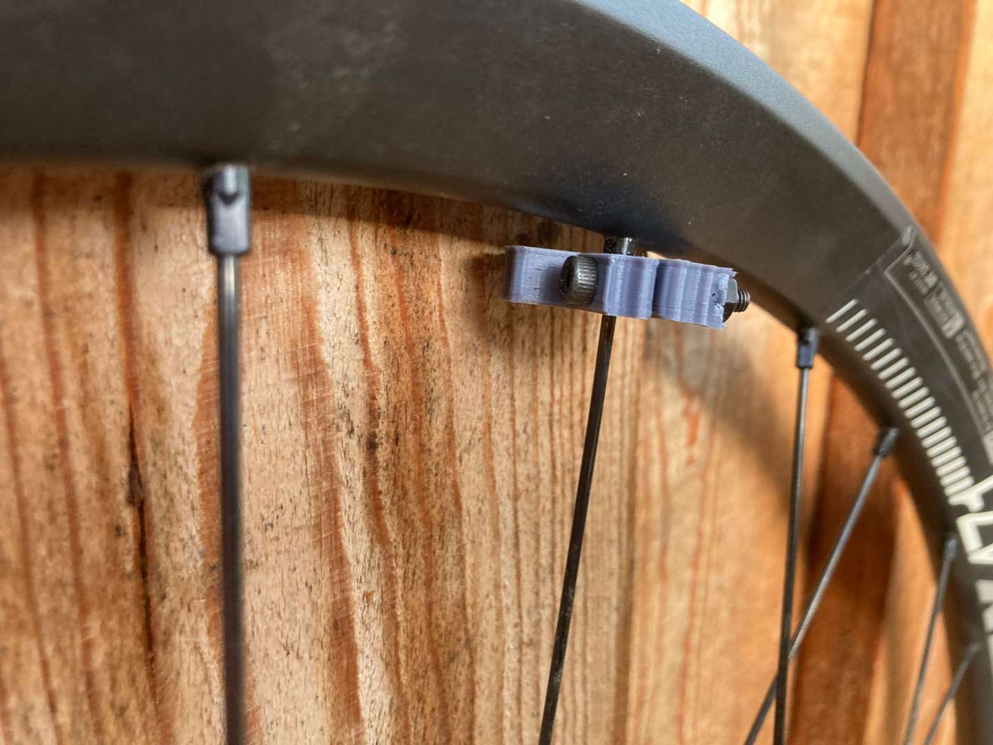

Posts: 1562
What you need is a nipple grab!  (stop laughing at the back!)
Whack that on, nip it up, remove spoke then stick new spoke in and tension up.  That one sits in my guiding bag.
Oooo want, but I'm a bit scared to google it.
