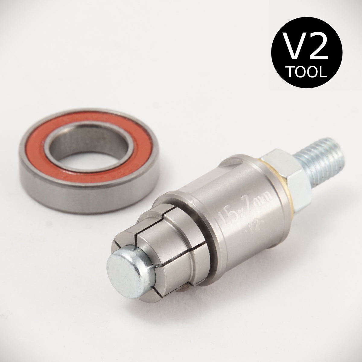

I've had reasonable success with the Bearing Pro expanding thingies on frame bearings where it's been impractical to knock them through.
https://www.bearingprotools.com/products/bearing-puller
You fit them inside the bearing, tighten it up to expand it into the inner race  and drift it through with a punch. Doesn't work with a blind bearing but should work fine with a hub.

Thanks Davros, that looks ideal. I've got various pullers and presses for car stuff. It all seems to come from China whether i spent a fortune or a few quid. The current bearings have done at least 11,000 miles so I wont use them often.

I use this kit https://www.ebay.co.uk/itm/233539319588 on my bike, I prefer it to the slide hammer approach but both do the same job.
