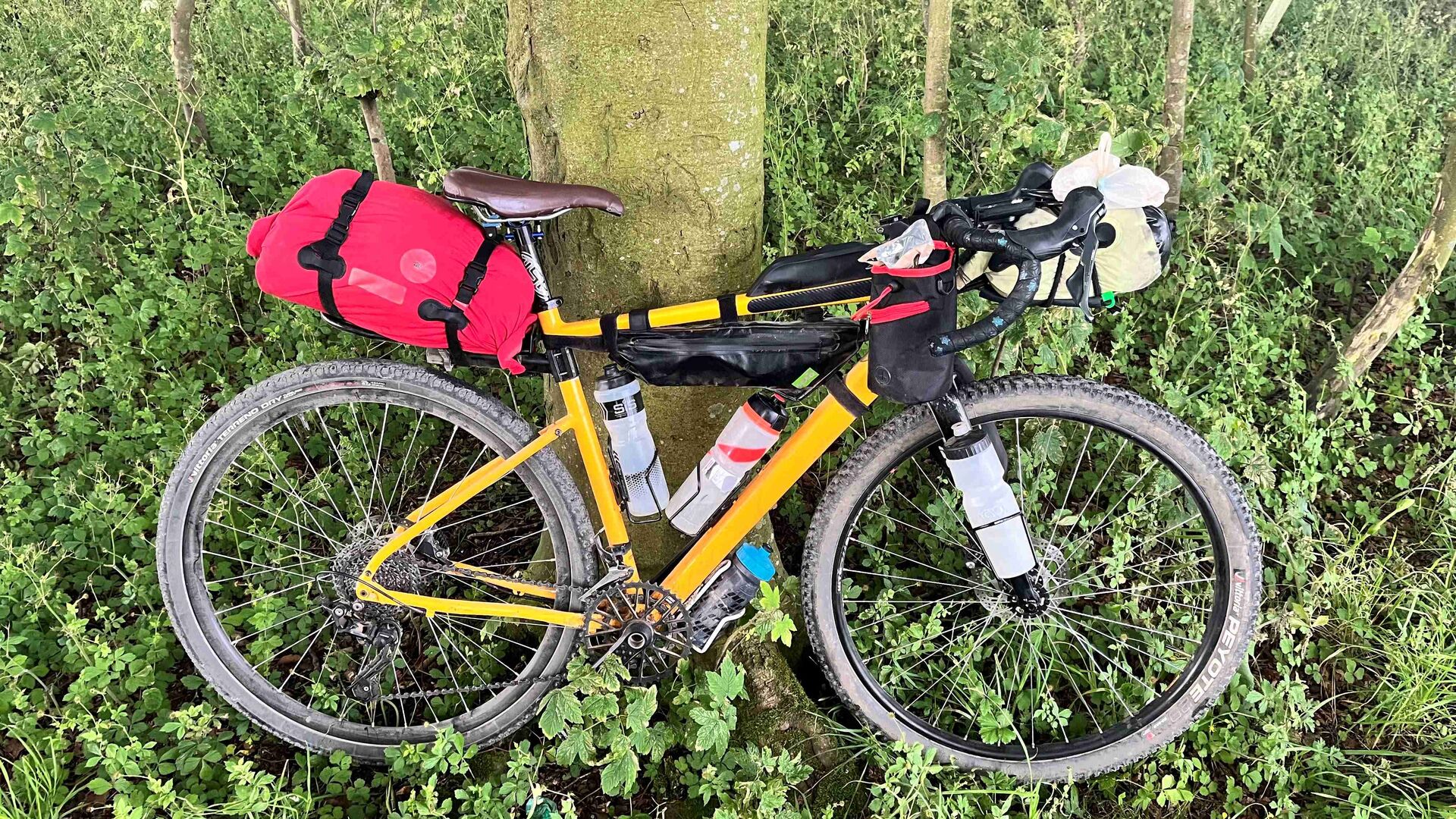

Mini update:
So my £7.50 eBay special rack arrived and I immediately chopped the last 3.5" off the beam bit and slammed the load platform to the back of it's adjustment in order to clear the rear tyre and minimise the mechanical advantage it has over the clamp. Clamped it on just below the Seat Tube/Top Tube Junction (not the carbon seatpost) with a bit of protection tape (probably still knackered the paint though).
Took it for a 100 mile overnighter along the Ridgeway this weekend, loaded up with a stuffed 20L drybag, it worked perfectly for the task, bounced it about on descents and yanked it about to load/unload, didn't miss a beat.
So I might look at "refining" the setup a bit, but based on this weekend it does a pretty good job of stabilising an relatively unwieldy Drybag.
I do however now need to think about my Front carrying solution as that presented me with some different challenges...
