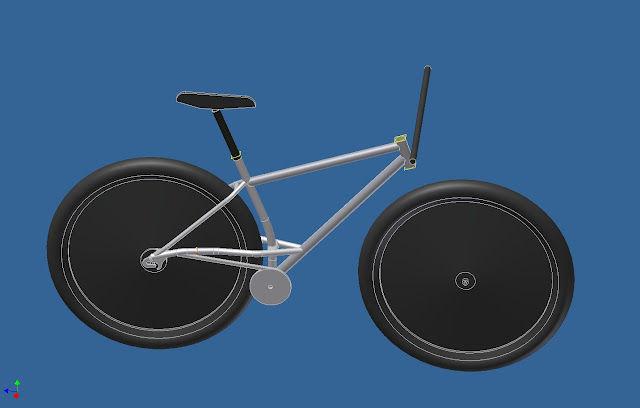

OP
Forgot to mention - I use Inventor at work. Modelling a frame is a bit of a faff - use bikecad if you are in a hurry. The easiest way on Inventor is to use framework tool, but faffy as you need to load up your own tube cross sections (not tried this myself). Also can't print off tube mitre templates.
I did mine as an assembly of revolved tubes. Tubes done as sheet metal parts, sketch one wall cross section and a centreline, then revolve 359.9 degrees. Once all drawn up as a frame assembly, you can "unroll" the split tubes to allow printing of mitre templates (maybe not an issue if you already have a milling machine for cutting mitres using holesaws).
