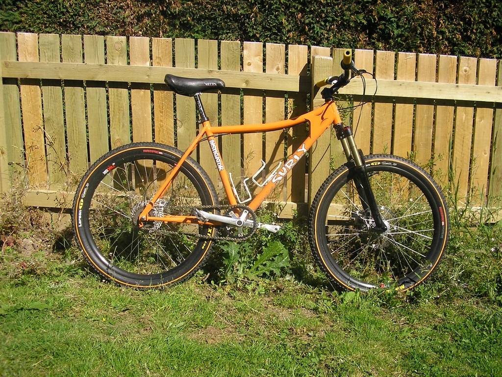

Posts: 17416
Magic ratio is the simplest way. A well lubricated quality chain will survive without adjustment for quite a while on a road bike, but on an mtb it will get slack quicker. Not a disaster, just try one more tooth on the rear or one more on the front. A halflink is also useful, but I don't like using them on an old chain.
This bike is still on the same chain 2 years later, but it's now pretty loose. It generally gets dry conditions only use.
[url= https://farm8.staticflickr.com/7055/6878381019_2885d02e43_b.jp g" target="_blank">https://farm8.staticflickr.com/7055/6878381019_2885d02e43_b.jp g"/> [/img][/url]
There is a calculator online for Magic Ratio, but I prefer to do my own manual calculations.
[url= https://farm8.staticflickr.com/7044/6939103183_3f76e91ef1_b.jp g" target="_blank">https://farm8.staticflickr.com/7044/6939103183_3f76e91ef1_b.jp g"/> [/img][/url]
[url= https://farm4.staticflickr.com/3164/4563343789_908485bd35_o.jp g" target="_blank">https://farm4.staticflickr.com/3164/4563343789_908485bd35_o.jp g"/> [/img][/url]
It's even possible with belt drive.
[url= https://farm6.staticflickr.com/5041/5279892316_003b5b2c7e_b.jp g" target="_blank">https://farm6.staticflickr.com/5041/5279892316_003b5b2c7e_b.jp g"/> [/img][/url]
It helps if you have a few rear cogs of different sizes, and ditto for the chainring, because that gives more possibilities.
If you want to spend some money, there's a couple of eccentric BBs available which give a small amount of adjustment, eg [url= http://www.trickstuff.de/en/products/exzentriker_KL.php ]Exzentriker[/url]
I have a few of those sort of things, but never had to use them because Magic Ratio does the trick.
BTW you can adjust a fixed dropout slightly if you are prepared to risk borking a frame. Just peen the edges where you want a bit more metal and relieve the other side of the dropout by filing it. You need to be very precise with this, and can end up with a stuffed frame. It's what I had to do with the belt drive because that is far more finicky about an exact c/s length and doesn't tolerate a little slack like a chain.
Posted : 21/05/2014 11:49 pm
