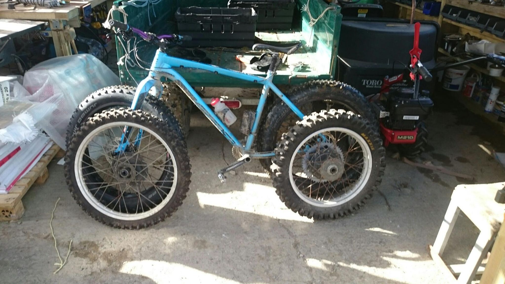

4.8" vs motocross tyres (full size adult ones, not kids ones):
Posted : 05/03/2016 12:08 pm
