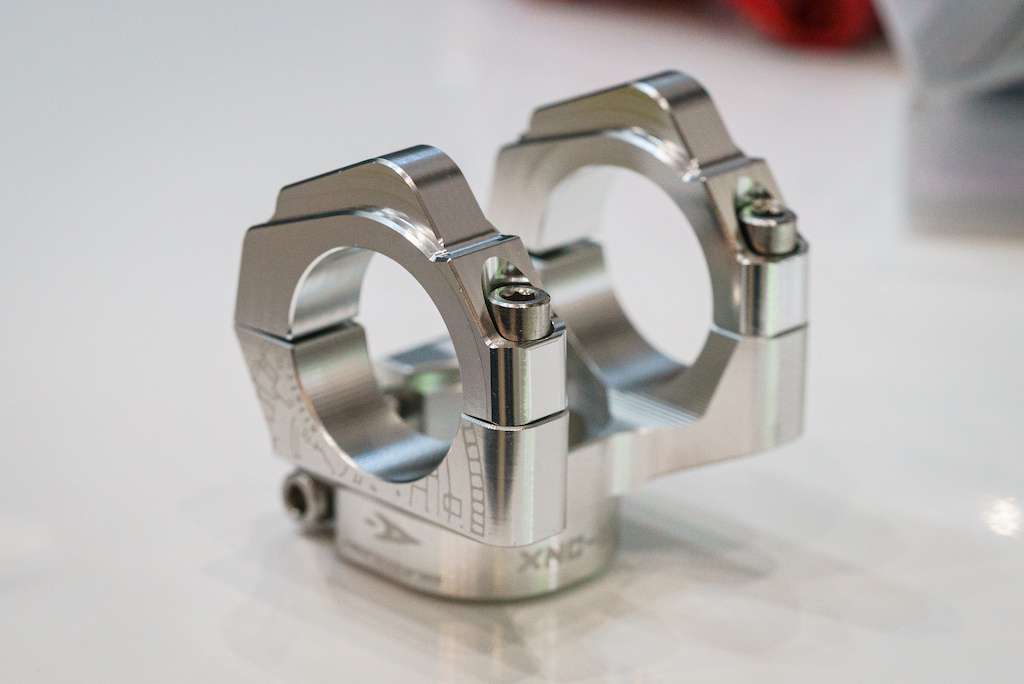

To maintain my favoured stack, reach and bars, I am looking for a short stem with a decent rise. I have tried higher-rise bars ( 60mm Spank and Surly Sunrise), but I need to rotate them to be comfy, which causes the reach to grow. I have the allowed 30mm of spacers under the stem and still need more rise.
I have an Ergotech High Ray, which is working well with my 38mm rise bar, but I wondered what other options are available.
Here are the oddities I have found so far:
https://www.ergotec.de/en/products/vorbauten/sub/ahead-vorbau/produkt/high-ray-35-0.html
https://yoshimuracycling.com/collections/stem/products/endh-stem-kit
https://boycomponents.com/en#rec191494751#!/tproduct/191495169-1589405676816
https://tanglefootcycles.com/discord/peeper-aluminum/
Suggestions welcome

That Ergotec stem looks errrrr . . .  interesting - but then what do I know? I'm running an ancient Mr Dirt - Wild Thing stem.  It's about 75mm tall and is great at getting a very comfortable position. Especially for downhilling.
Bottom right on
https://www.mtbr.com/attachments/1005391102mrdirtstem_s-jpg.177250/
Or there's  Rulezman stem - bit rich at 274 Euros though!
Posted : 11/03/2024 2:06 pm
Posts: 3416
Interesting looking option HERE (about 1/2 way down) from Aerozine
$64 direct
p5pb26320991
