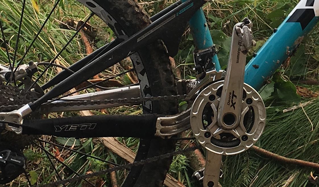

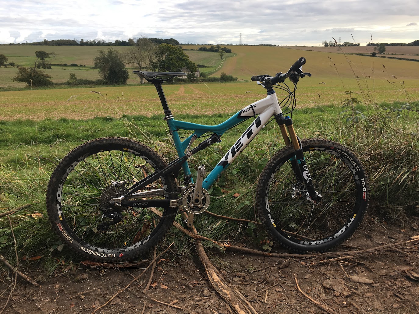

Same as those 2 ^^
I even have a pikcher
[img] http://tinyurl.com/y9ao43q3 [/img]
Closer upper
[img] http://tinyurl.com/y7gdcf4c [/img]
Son has requested same on his ride to school bike to prevent school-trouser > chain inerference
Posted : 13/10/2017 11:28 am
