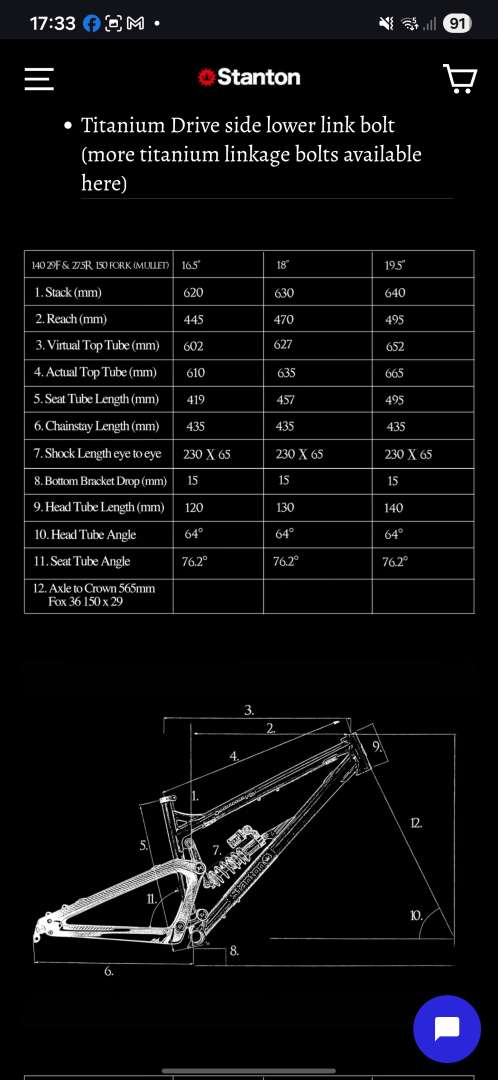

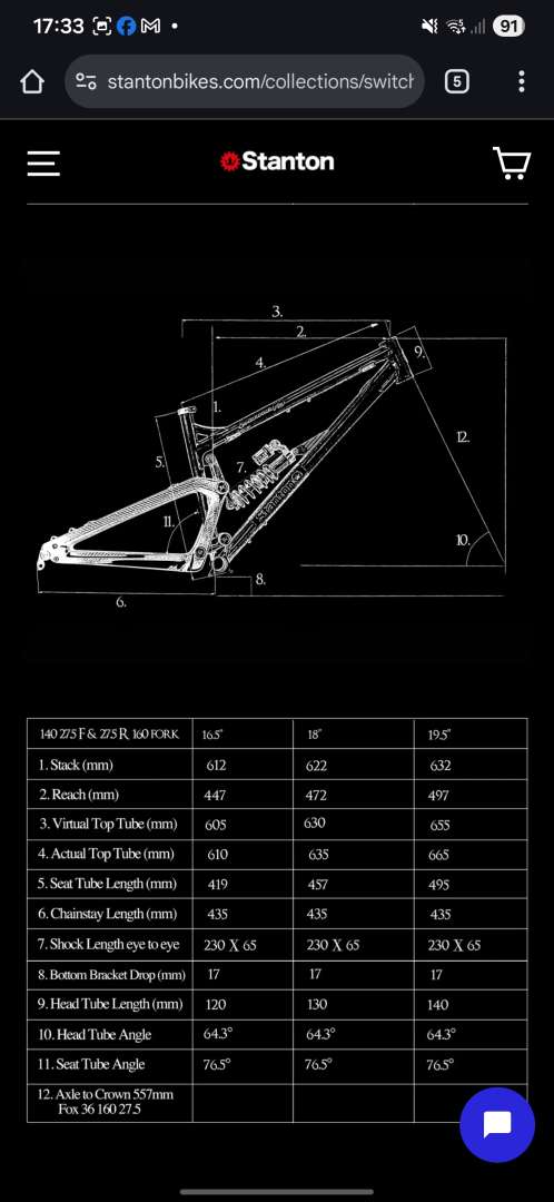

Rather than give the OP a kicking, maybe it's worth considering what frame would be used and what numbers are involved?
And also what fork
Take the Stanton Switchback FS - it's designed to be run as full 27.5 or mullet
Here are the comparison figures
Posted : 05/01/2026 5:37 pm

Take the Stanton Switchback FS - it's designed to be run as full 27.5 or mullet”
Those Stanton charts have been made whilst forgetting to change the front wheel size as well as the fork axle-crown (and the A2C data is a bit sketchy too)…
If you know what you want/like in terms of geometry then you can figure out how changing a bike from stock will work for you, especially if you reference from a bike you know well.
