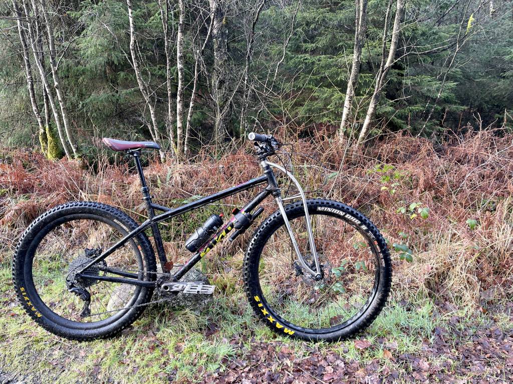

Posts: 349
I've done it (and still got it) as a rigid bike using a Jones fork and a 3.0 Minion. I also tried it with a Reba at 100mm. The rigid I bloody love, definitely big BMX style of a bike, a great balance between being playful and confidence inspiring. Obviously it's not an easy to put together combo, but I had a Jones spaceframe that I cracked, so had the fork going spare.
The version with the 100mm Reba was fine, but slightly neither fish nor fowl. Let like it wanted to be ridden like a hardcore hardtail, but didn't have the travel to make it work. Obviously that makes it sound like the rigid bike wouldn't work either, but I guess I ride that like a rigid bike with benefits...

Posts: 107
sanername got any pics of that?  Sounds interesting.
Posted : 16/06/2023 10:42 pm
Posts: 349
Something a bit like this
stooge moto bars, pedalling innovations and 9 point 8 dropper are the other highlights

That Jones truss fork thing is an abomination in the best possible way. I do actually have a vaguely suitable rigid fork so that might get given a go as well!
