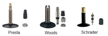

There's different widths, just get the one that matches your tyre. You can get away with a bit over or under if you need to. There's a few different valves. You probably want schrader

Some kids ones have woods valves not sure why. No reason not to 'upgrade' schrader. I suspect a brompton's will be skinnier, aren't they 16" anyway? Generally a tubes a tube, especially at this end of the market.
