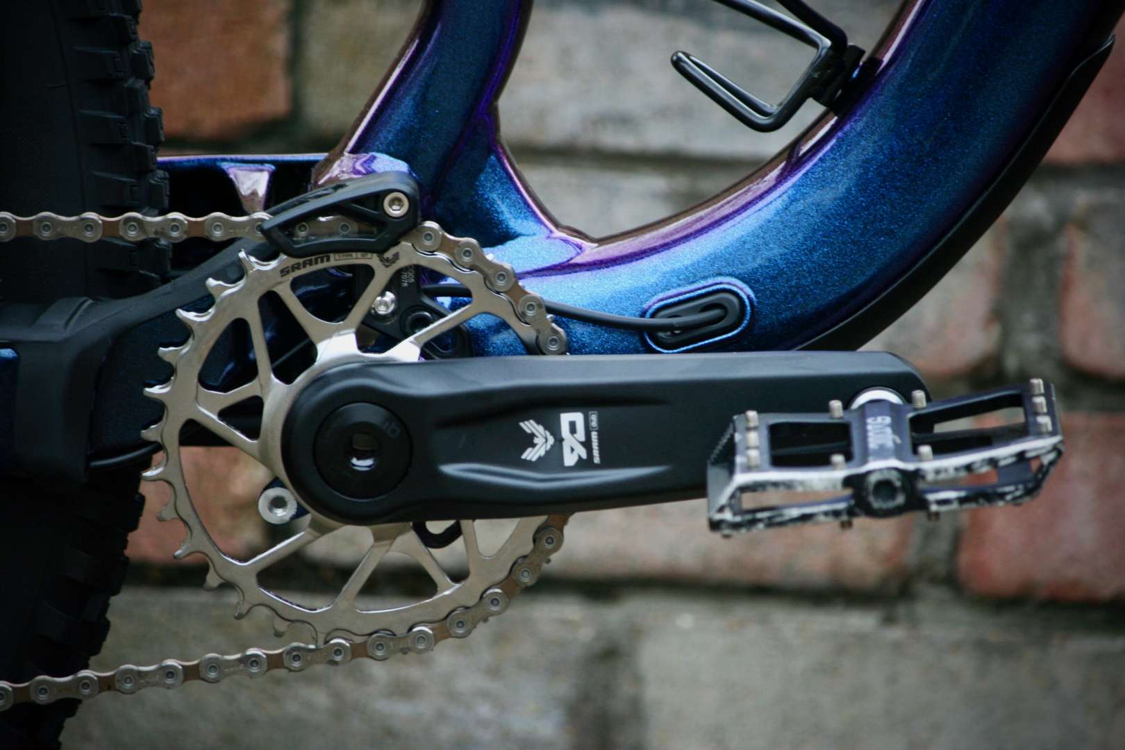

Thanks for the suggestion @BruceWee. Dinky little 155mm Eagle 90 cranks now fitted 😀
Ditched the bashring bits as I'd rather they had the upper chain guide.

Posts: 941
I ended up with the Eagle 90's for my lad's bike aswell, seem pretty good so far and the ring works with any old chain (as your pic shows) not just the flat top Sram one it said it would.

Posted by: Burchy1
It did have Goldix ones, but as he's got better/bigger/more brave he bent them at BPW 🙄
Interestingly (or not...) about chains. Their new bikes came with SRAM drivetrain which I swapped in favour of a Deore/SLX cassette/mech/shifter. Tried the Shimano 12sp SLX chain which felt and sounded rough AF on that SRAM T-type chainring. Swapped to the 12sp NX chain the bike came with: smooth and silent.
I was admittedly a bit ignorant of T-type compatibility until now 😀
