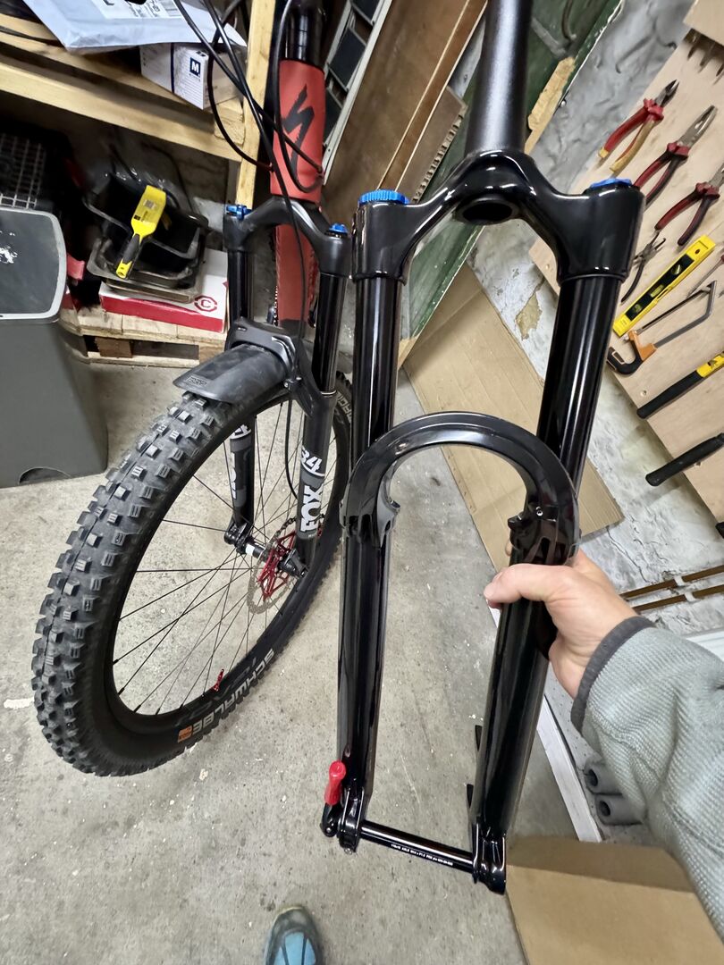

New 36 arrived. Turns out they are 2022 when I registered them with Fox. The NA3 spring was a bugger to fit, it really needs some pressure to get it all the way in.
the crown is slimmer than my mk2 34 on the hardtail and the newer 36 on my wife’s stumpie.

Posts: 9062
Posted by: P20
Can you not take the air cap off for an easy life?
Posted : 03/07/2026 5:29 pm
 P20
Posts: 4343
Posted by: Rubber_Buccaneer
Posted by: P20
The air cap was off.
I rang Jtech where I bought it from. They said the double seal on the negative chamber did make it tight. They recommended placing steerer on the floor and push hard! It worked.
