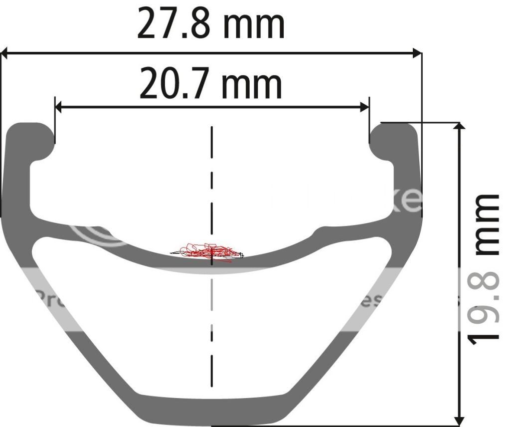

This is a jpeg of a EX500 rim,
when changing tyres,put one side on,making sure the bead sits in the red area,before putting the other side on HTH
Posted : 11/09/2012 1:09 pm

dingo - cheers for the jpeg ;o)
