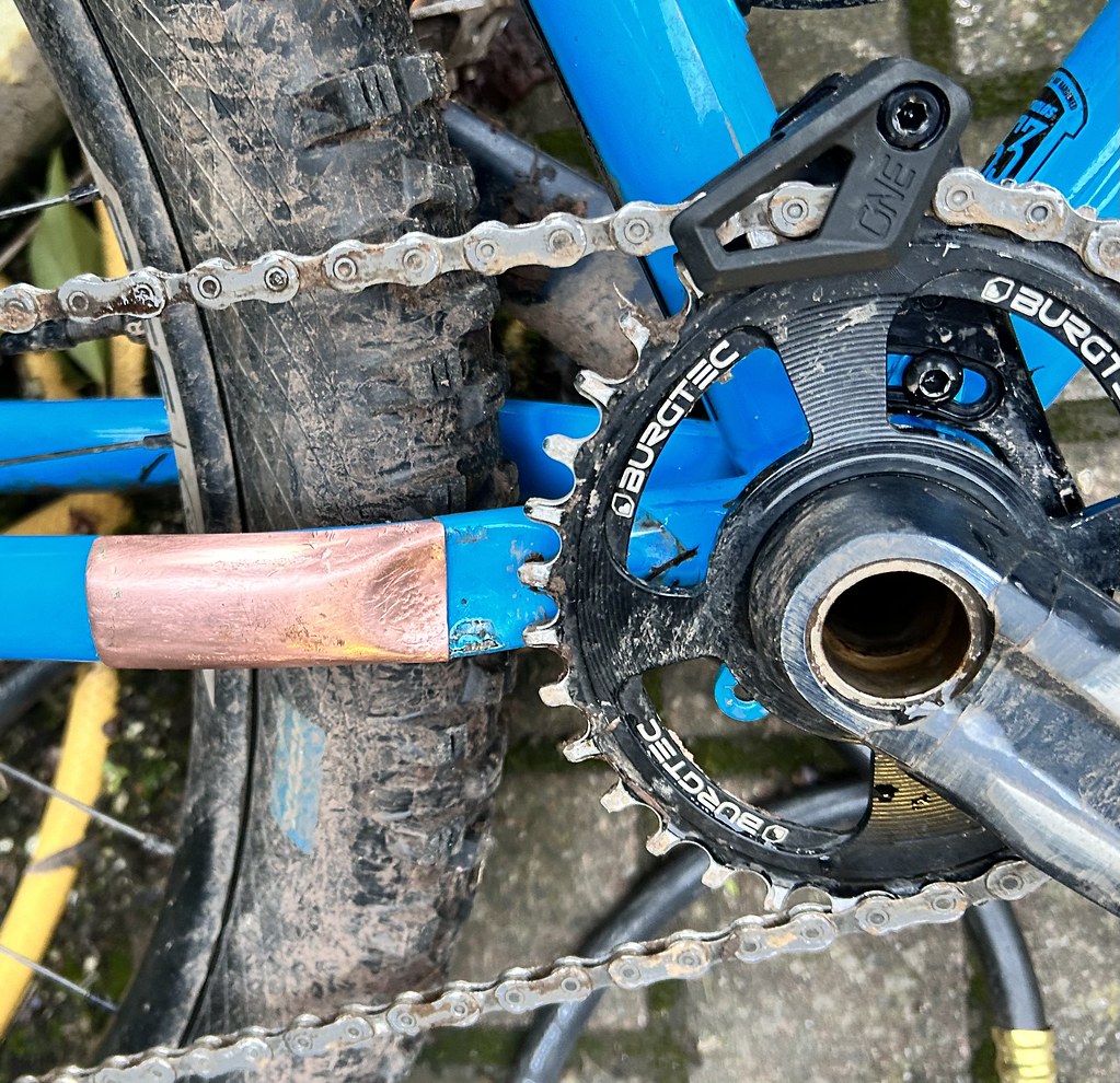

Had some chainsuck issues on mine but probably a combination of  a) old transmission and b) it's been insanely muddy and c) stiff link in chain.
My mate made me a custom chainsuck plate tho. Awesome job,
https://flic.kr/p/2obuy7n
Double taped the other bits after dabbing it with rust-stop. Think I'll run a 30T oval when I change transmission in Spring as it runs pretty close to chainstay with a 32Oval.

What's the chainline Alex?
Posted : 17/01/2023 12:16 pm
 Alex
Posts: 7904
Boost. 52mm offset on XT Cranks. Think I have std spacers on BB. With a big ruler from chainring to cassette it's about 5th/6th so I reckon it's okay. 51T cassette tho so it's not great at the top. Had chainsuck in 3/4. Anyway don't want to derail thread, not worried about it, happened at night so I didn't catch it. Going back to a standard SLX ring as chain was definitely hanging onto that burgtec ring (it doesn't look that worn but...)
