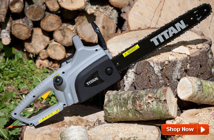

FunkyDunc - Member
Oh now theres a question, what saw for cutting logs??
I bought one of [url= http://www.screwfix.com/p/titan-ttb355chn-40-5cm-2000w-electric-chainsaw-230v/92771 ]these:[/url]
and one of [url= http://www.ebay.co.uk/itm/METAL-CHAINSAW-LOG-SAW-HORSE-HOLDER-SAWING-/120827232887 ]these:[/url]
Total spend about £100. More than a handsaw but it gets through a pile of logs in minutes.
