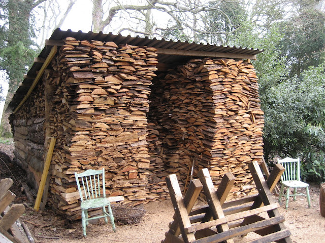

No stove thread is complete without a gratuitous wood pile pic.
