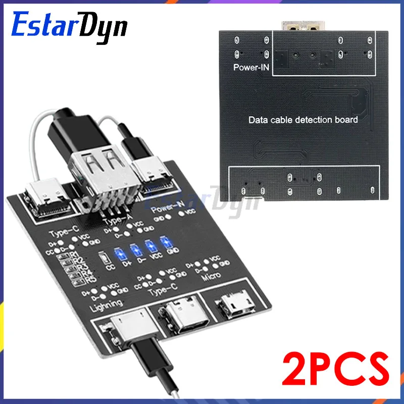

Get a cable tester from AliExpress.  I got a two-pack for something like £3.
Posted : 29/11/2025 12:03 pm
Posts: 79318
https://www.aliexpress.com/item/1005008696290151.html
