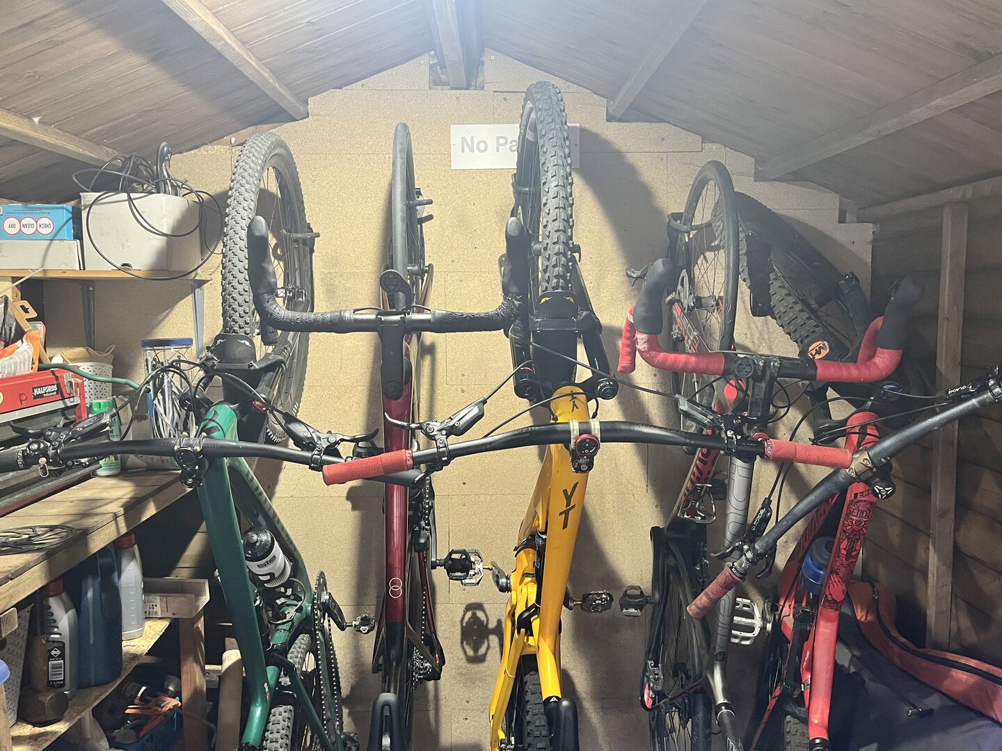

 IMG_8726.jpeg IMG_8726.jpeg IMG_8725.jpeg IMG_8725.jpeg I just used basic hooks on loft boards to store bikes upright in the shed - easily get 5 in…

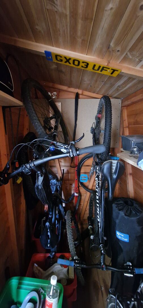

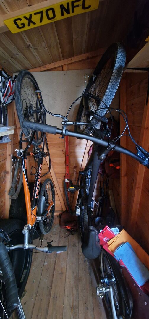

Posts: 2711
I've done something similar to Big daddy, with hooks on backing board mounted to shed struts. Mine is a pent so a high side for the 29ers, and hooks at an angle to make a bit more height, and get wide handlebars out of each others way, and hanging 26s upside down. 20260621_143143.jpg20260621_143151.jpg

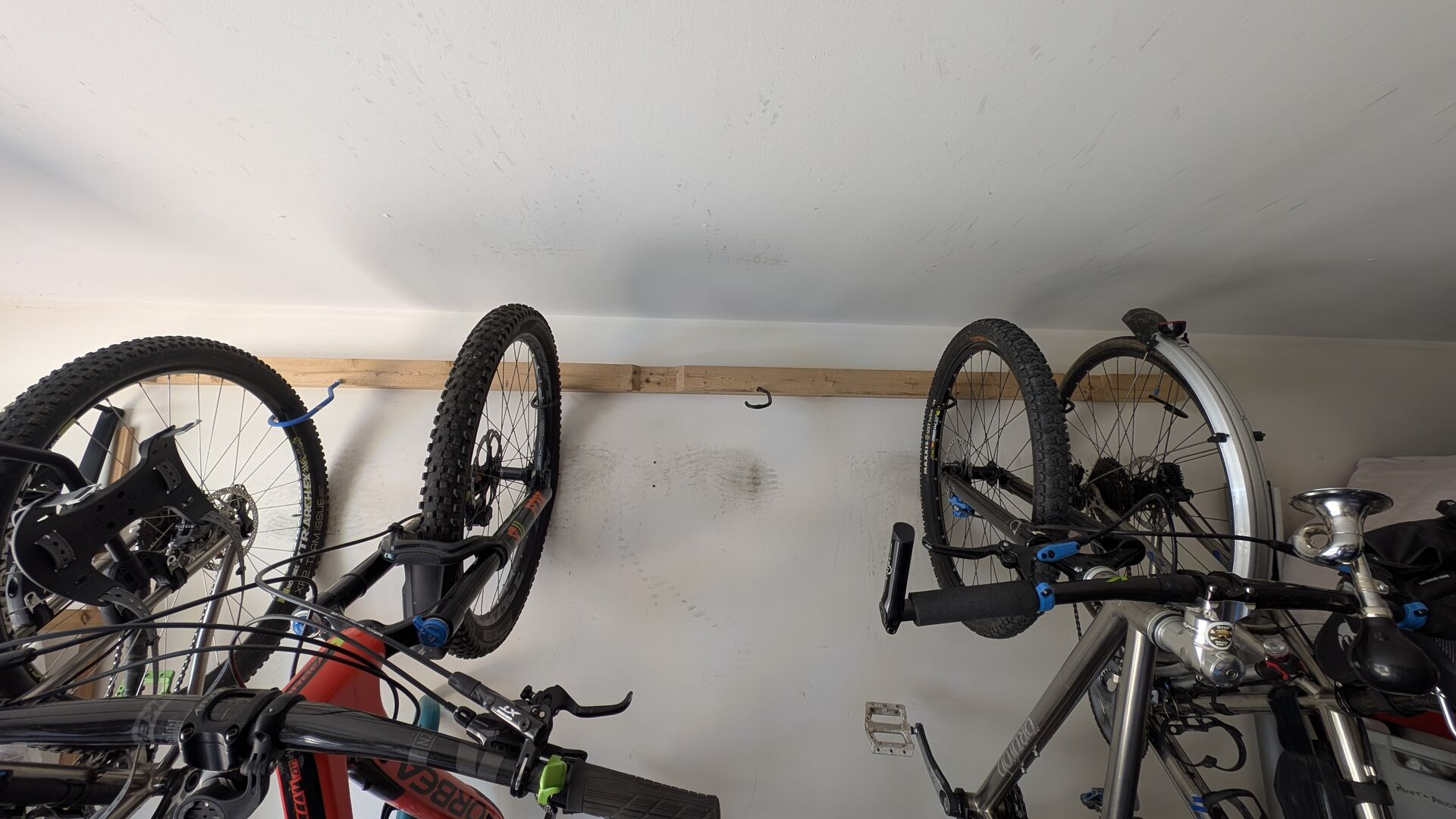

Posts: 44148
Nothing fancy here. A wooden batten screwed onto the wall then cheapo hooks screwed into that.

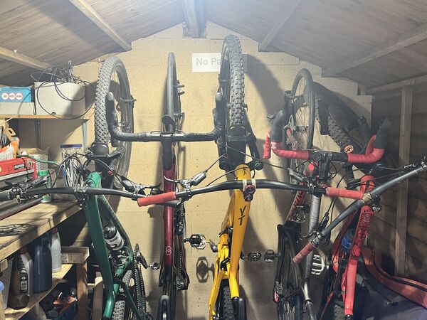

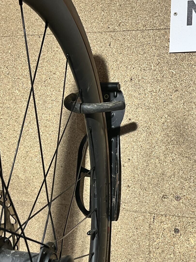

Posts: 6696
I used the gear hook system. It was super simple and easy to install.
Put in three racks with 3 hooks on each. Being able to move the height a bit was useful to stop bars and pedals interfering. Also adjusting the horizontal position to give a bit more room for the two MTB. Worth it. Less drilling than doing everything individually.

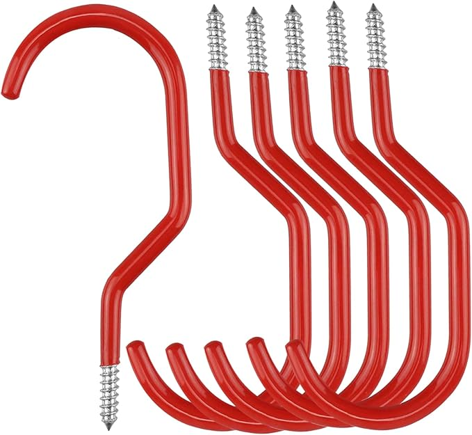

Currently have cheapo hooks option, with bikes alternating up/down and I set the hooks level which isn't ideal so heed advice mentioned above.  I've got some hinged hooks like bigdaddy's which I need to get around to fitting so that I can rotate them as required to make more space to get 1 in removed link  The sliding rails look really good but can't justify the additional cost....

I've recently installed the rak.bike sliding rail as linked above and as a result have several hooks like these going spare if anyone needs any...
