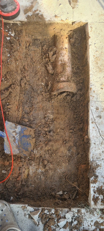

Having my ASHP installed this week and the pump is unwrapped and standing on my 1970's patio. Installers happy to simply connect it there but I have a better idea....
I want to pull up 2 old patio flags, whizz a bit off another 2 then fashion a concrete plinth for it to sit on. Surround with nice stones then when I replace my patio I wont be looking at remnants of the old patio. No worries they said, you do that and we wont be connecting until Thursday. Take flags up this pm and found this pipe....... There is no debris in the hole I havent damaged another part of it and other than some soil/clay in the end of the pipe, no smell or water backing up. Toilets working fine, drains etc etc.
I would prefer to remove it as it will impact the depth of the concrete pad I was putting in but I am nervous..... WWSTWD?

Smash it up and crack on - if it were live you’d find a lot more than a dry old soil pipe.
Does it look like it goes to where an old outside loo may have been.
…and I hope they are steel toecap crocs! 🤣

Looks like an old soil pipe. Abandoned as it's not attached to anything. I'd just smash it up into a bit of hardcore.

It isn’t connected to anything at that end so that bit isn’t doing anything. Smash it up and take it out or if you are feeling super cautious you could cut it square with an angle grinder.
Running out of time to pour a slab that you want to take a load on Thursday…
No I don't think there was a loo there. Was in my post work, reflection phase when I put my Crocs on 🙂

That kind of pipe is is used a lot for highway drains, land drains and rainwater round our way. Might be part of an old run from gutters to a soakaway?
