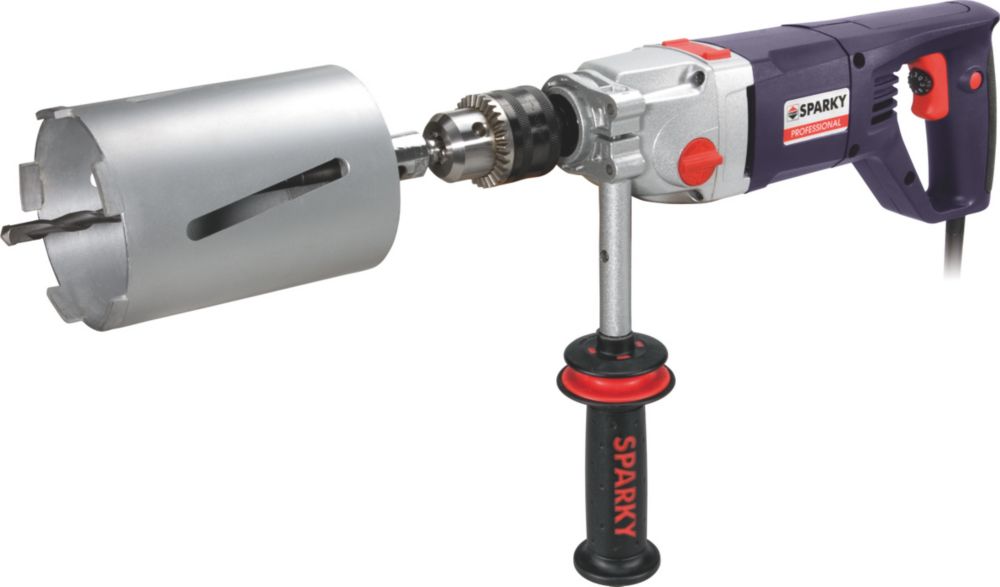

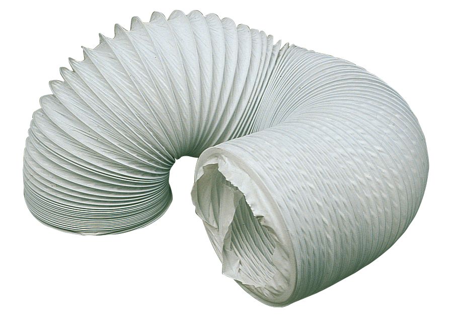

You can hire a 102mm core drill [img] http://s7g3.scene7.com/is/image/ae235/39624_P?$p$ [/img] from your local builders merchant/hireshop and cut a hole in the garage wall. They will also have 100mm flexy duct and termination fittings to make a nice neat run and weatherproof the opening too. (or go to screwfix

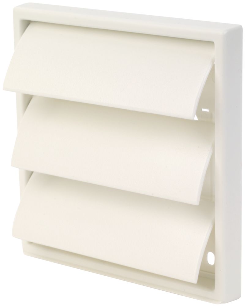

http://www.screwfix.com/p/manrose-square-white-140mm-louvre-vent/14434 [img] http://s7g3.scene7.com/is/image/ae235/14434_P?$p$ [/img][img] http://s7g3.scene7.com/is/image/ae235/18561_P?$p$ [/img][img] http://s7g3.scene7.com/is/image/ae235/18232_P?$p$ [/img]
