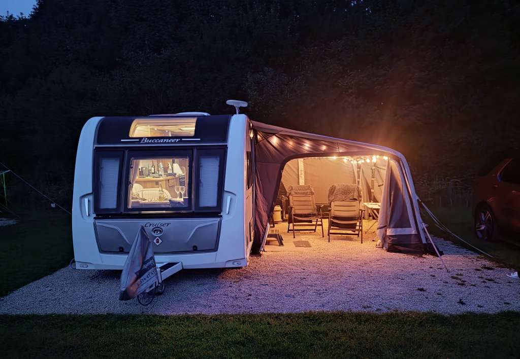

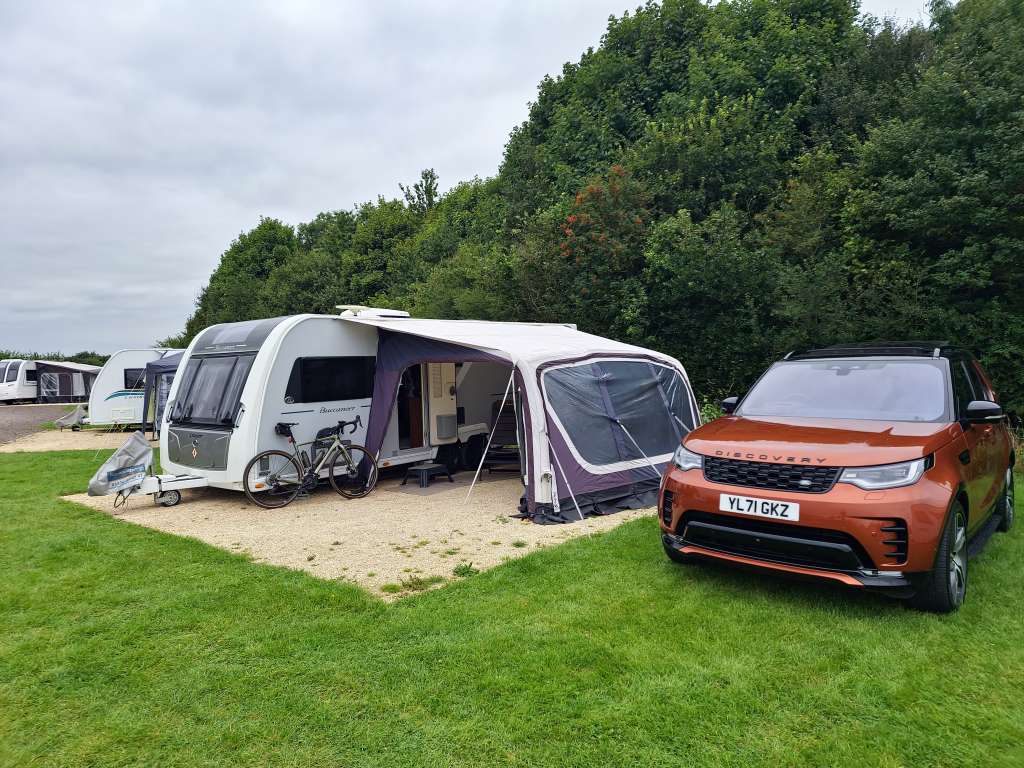

Me and MrsRNP are new to towing a caravan but we've had a large Ifor box trailer that we towed with our 110 Defender.
Imho - towing on A roads/motorways etc is easy, it's tight twisty single track with tractors coming the other way that the stress levels start ramping up. The quiet small sites that we want to be on are often down this type of road/lane. We deliberately bought a small caravan even though our tow car will do 3.5t as there are only the two of us and dog.
It works really well for us (just been away again this weekend), quick and easy to deploy. I couldnt cope with the stress levels large double axle 'vans would involve.
