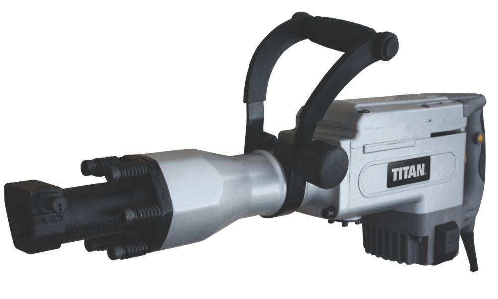

Posts: 13594
I bought one of these: http://www.screwfix.com/p/titan-ttb280drh-15-5kg-breaker-230v/67819
[img] http://s7g3.scene7.com/is/image/ae235?$p$&layer=0&size=281,281&layer=1&size=281,281&src=ae235/67819_P [/img]
Pays for itself verses hiring if you would have to hire a tool twice.
NB you're welcome to borrow it if you're near Cambs....
Posted : 07/05/2014 2:46 pm

 iolo
Posts: 194
Foundations you say?
Can't you just infill over them and turf?
EDIT @ BINNERS [pedant] you say you got a pneumatic breaker but that picture is clearly an electrical one [\pedant]
