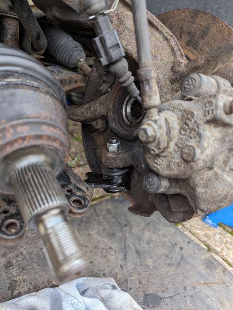

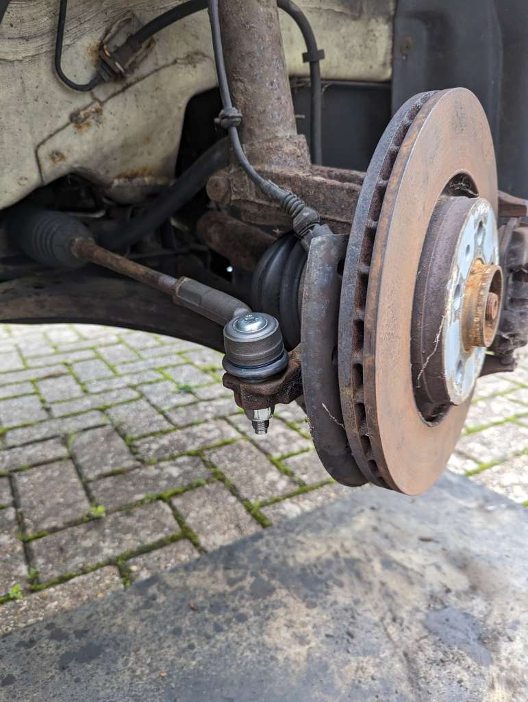

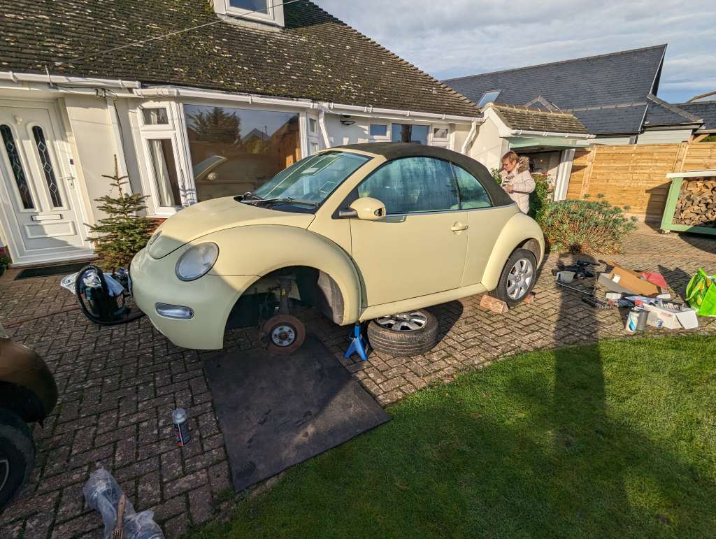

New Track rod ends and suspension ball-joints fitted..<br />Both wing mirrors needing replacing.<br />Soft top switches need replacing..<br />Thorough clean and de-mould needed!

Good luck with the track rod ends
All done.. the nuts wouldn't come off, so just hacksawed through the bolt as the whole trackrod end was being replaced.. new shiny shiny ones on in the photo up there..^^^

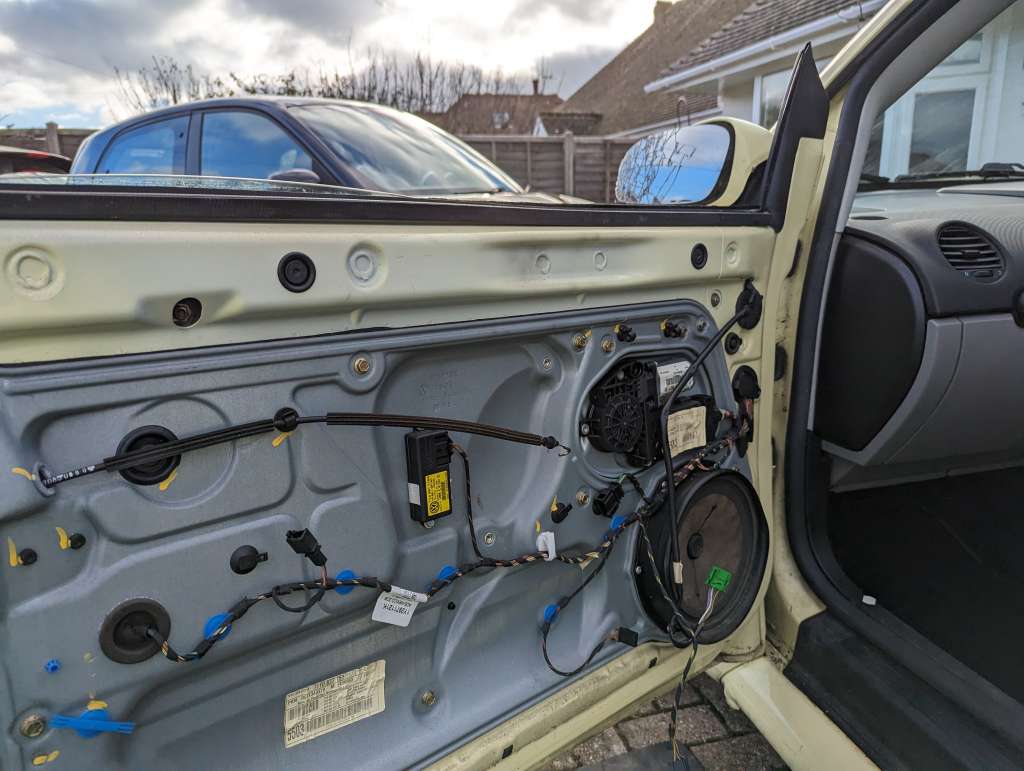

Haven't yet decided if I'll get the key programmed..but the passenger door lock mechanism is kaput!
So looks like I'll have to have the door card/window off (again) to replace the lock mechanism that side!

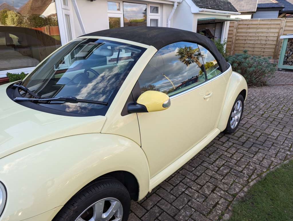

PXL_20231124_142013143
Polished up pretty well eh!
