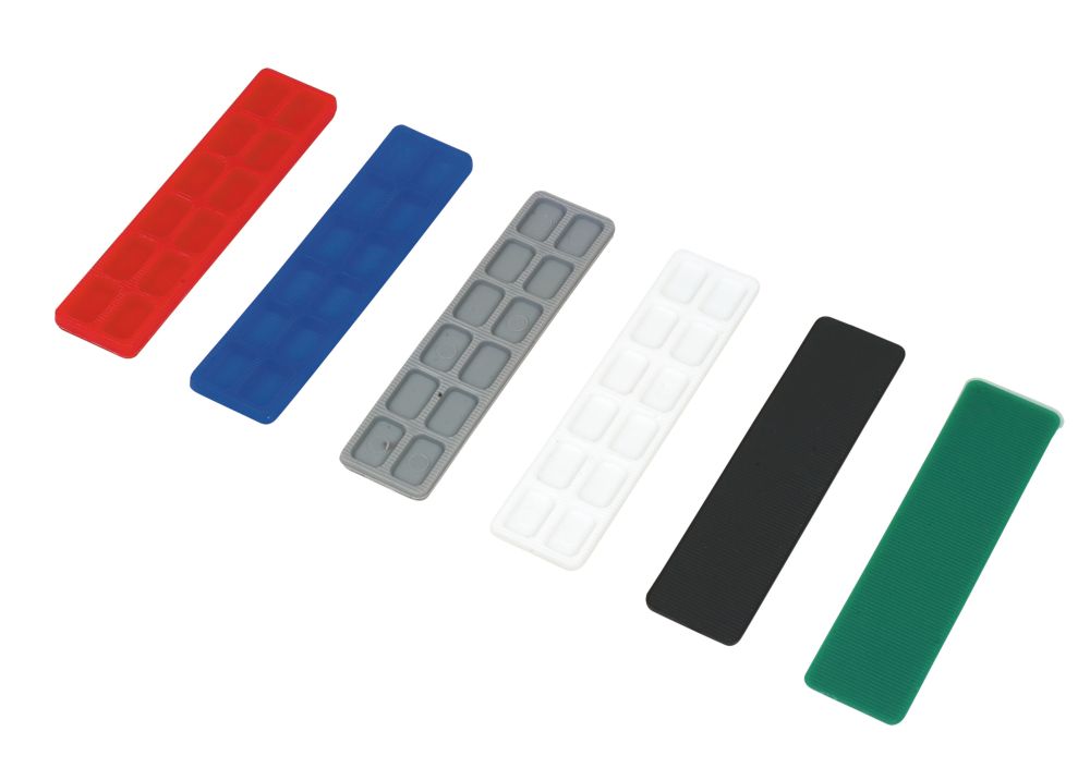

I think I've seen those plastic packers in Screwfix's catalogue and wondered what they were.
I'd worked out there would have to be some sort of flexible mounting for the glass to allow for any possible movement of the timber wall. I guess that's it.

packers:
http://www.screwfix.com/p/glazing-packers-24mm-225pcs/96089
[img] http://s7g3.scene7.com/is/image/ae235/96089_P?$p$ [/img]
