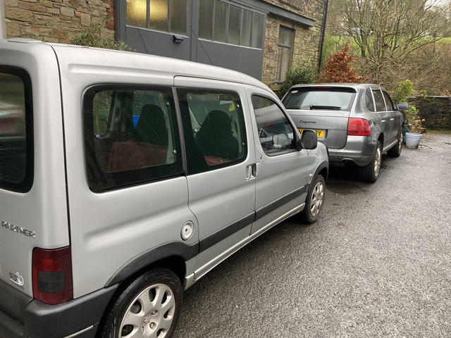

Update - after a week of eBay/autotrader and MOT history I've bought a Pug Partner Escapade.
83k miles, 04plate, 2.0HDI, unicorn car - paperwork for rear axle, shocks and brakes replaced in 2019 @ £950, clutch and cable @£300, gear linkages plus regular servicing, 4xnew Continentals.
Mint condition.
Needs a top strut bearing and bottom ball joint are on MOT as advisory so £250chipped off and I'll do them myself. £2450 due to Covid inflation.
Happily drove it 50mile home.

Boring update but this little French van car thing has passed another MOT today with no advisories. Not bad for a 20 year old car!
I must say that its slowly become one of my most favourite vehicles I've owned, it's fun to drive in a soft roly poly wobbly kinda way, parts are cheap, it's easy to work on and it's economical to run. Pity MrsRNP hates it!
