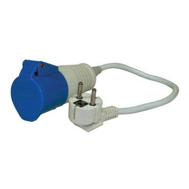

We got caught out in Europe last year by campsites having standard Euro 2 pin plugs, so finally we were able to go to a campervan shop and buy a converter - about €5 I think. Just about managed to get out without the 5 berth van reduced to €35000 from €50000.
One of these
[img] http://i1.adis.ws/i/washford/1434957918611a?$pd_main_v2$ [/img]
Posted : 17/07/2016 7:42 am
Most European sites will have the blue 16A 'commando' weatherproof hookups (though not all will be rated to 16A). Some may still have 2-pin plugs like that, but they're old and dying out.
From recent personal experience about half of the French, German and Italian campsites we've stayed at in the last 2 years still have 2 pin supply. For €5 it means you get power.
