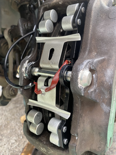

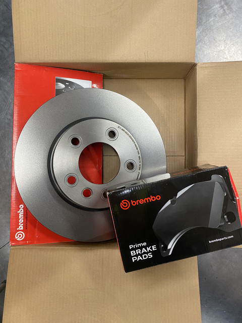

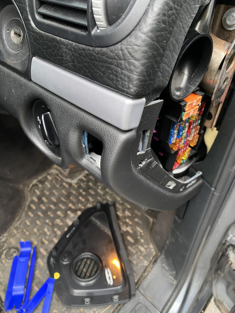

Small update.
Going aurora borealis spotting in the porker the other night reminded me that the tailgate struts needed changing (common Cayenne fault). It's not very romantic trying to both sit on the boot lip with the sudden death of the clothes prop giving way and the tailgate decapitating us.
Removed rear C pillar trim and a small section of roof lining. Few clips and trim to access the struts. 30mins of fiddling and swearing had them replaced. Replaced everything - boot works properly again.
Cost for all 4 struts was £80 for Stabilus OEM.

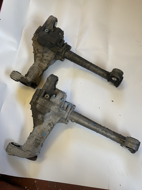

The front differential is noisy - again it's a common Cayenne fault. The official Porsche service schedule is 160k miles! The front diff only holds 1litre of oil.
I changed it a few weeks ago and went to a heavier gear oil (thicker) ran it for 2weeks then dropped it again. It was black with a shimmer so definitely on its way out.
Replacement diff sourced for £130, along with replacement Corteco seals. Plan is to change it in the next few weeks.
Fixed bulb dimmer switch that had been pushed through🤷‍♂️
Drug dealer spec rear window tints removed.
Cost so far ~ £1300

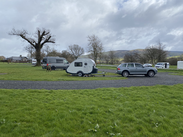

Birthday update.
Arrived on a site near Bala North Wales late last night so just parked it and quickly set up. Our friends in 'Lucy Walker' (Jay is a mountaineering nutter) the VW Crafter arrived shortly after us.
Turned caravan around in the morning so the door/sunshade is out of the wind.
Bacon and egg buttys always taste better when camping!
Had a mooch at the awesome petrol stations in Bala, currently having a beer.
Staying on here till Tuesday then heading towards the Shropshire border to see other friends then heading a bit further north as another friend is coming camping with us for a night then back home on the Easter weekend.
Car tows brilliantly - doesn't have a huge amount of torque but using the 'box in manual mode you can keep the revs up a bit and keep it in the sweet spot.
Fuel economy wise - towing it's doing 20-21mpg.
Not towing it did 31.3mpg going to Gateshead up the A1 to collect the caravan.

Posts: 6699
Just because it's a cheap car doesn't mean it gets cheap parts!
New front discs and pads cost 0.5 of a Porsche (plus £60 for new caliper pipes, pad fitting kit and wear sensors).
[url= https://i.ibb.co/FzP9JNH/IMG-7707.jp g" target="_blank">https://i.ibb.co/FzP9JNH/IMG-7707.jp g"/> [/img][/url]

Posts: 6699
Front diff swop last weekend (noisy pinion bearings).
All bolted back together now but rebuilding front brakes as they were a bit grotty.
[url= https://i.ibb.co/n6nYpM5/IMG-7670.jp g" target="_blank">https://i.ibb.co/n6nYpM5/IMG-7670.jp g"/> [/img][/url]
New OEM seals fitted to replacement before fitment.
[url= https://i.ibb.co/xqGHN5k/IMG-7673.jp g" target="_blank">https://i.ibb.co/xqGHN5k/IMG-7673.jp g"/> [/img][/url]

Posts: 6699
Calipers removed and cleaned up, piston and seals okay but dust covers replaced.
New Brembo discs&pads/bleed nipples/rigid pipes/disc bolts/pad retainers/wear detection cables. Full brake bleed.
Front end suspension components cleaned and Fertan applied whilst brakes removed.

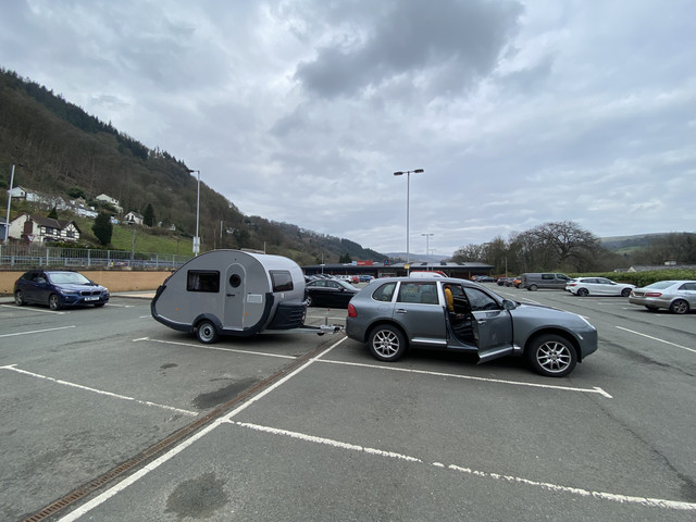

All back in one piece now and been for a spin in it. The £130 differential was a good punt - the drivetrain is quiet as it should be now.
Ready for bank holiday caravanning - at least you won't be stuck behind us!
