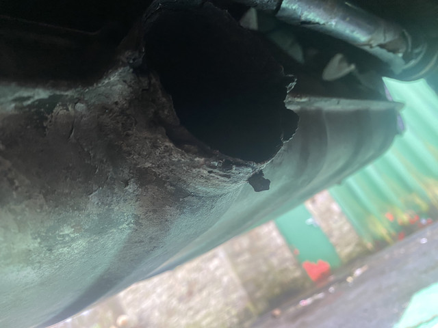

MOT results tomorrow!
Ooft
Pass! (with plenty of advisories!)

Not a terrible list for a £500 car!
Fuel tank straps seem to be a common fail point on old Pork.

What will you do about the rear subframe (seeing as you're not scared of taking cars apart!)?
Posted : 22/12/2023 2:54 pm
Posts: 6699
and certainly one as complex underneath as an early Cayenne
The straps are £23 each so no biggie!
What will you do about the rear subframe (seeing as you’re not scared of taking cars apart!)?
I'll probably do the same as I did with the XC90 - drop it all down, strip it apart, take it to my shot blasting man then Zinga cold zinc coating as a base with epoxy over the top.
Dinitrol squirted inside. Rebuild with new bushes etc.

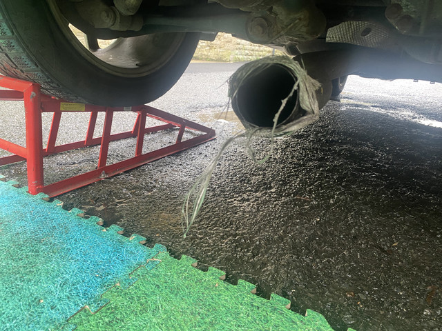

Bit of an update.
Found and downloaded the factory workshop and parts ID manuals on Scribd. The workshop manual PDF is 170mb and 6024 pages! The parts ID is 800 pages. Info👍
Took the MOT advisory wheel (that had the bolt/nail in it) to my back street tyre man for a repair. Sorted for £10.
Kwik fit would have been a new tyre....and recommendation for a new battery and shock absorbers.
It's missing the bonnet emblem, replacements appear to be Porsche only (£150), however AliExpress have them for £12 but Porsche copyright protection appears to reach China so the seller doesn't actually mention Porsche or show an image so it's pot luck to what is actually going to arrive!
Volvo design +1
Porsche design -1
The underside is generally in good condition regarding corrosion but there's a design flaw on the rear doors. The door extends into the rear arch, there's a substantial outer seal and an inner in case water gets into the area. But there's a lip/return on the door skin's that collects mud and water. Rust has set in quite badly on mine. I've ground it out and applied some Fertan for now but I'm on the look out for a replacement in better condition. The nearside door is fine.
Wash your cars better people!
The Xc90 in comparison has a removable plastic arch that collects any crap.
OEM service items ordered from Autodoc, Mann filters, ZF gearbox filter kit, Gates aux belt, NGK 'plugs.
Sprayed downpipe/exhaust bolts in readiness for dropping the complete exhaust off for repair.
Not much else to report, nothing untoward found, it's on SORN so not being used till it's serviced/exhaust repaired.

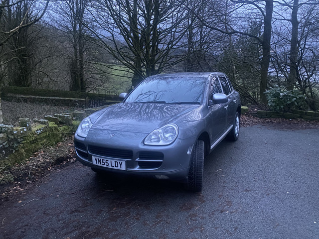

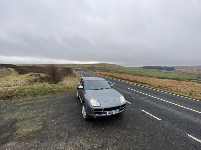

Another small update.
Changed oils - engine, front and rear diff, and transfer box. Couple of plugs were tight and needed some heat on the casings.
Cleaned up the front subframe and applied Fertan (will do for now till I have time to do it properly).
Stuck replacement Alibaba badge on bonnet.
Insured (£460) and taxed and went for a spin in it!
OMG! What a machine! My daily driver is a 20year old Berlingo so this is somewhat of an upgrade!
The autobox is dimwitted though - I don't know if it needs it's adaptations resetting but it changes a lot unnecessary. I've been driving it in 'manual' or shifting up using the tiptronic wheel buttons.
There's a whine on the front end, possibly either the diff/propshaft/wheel bearings. Not a problem will sort it👍
Amazing bargain for £500!

Oh oh! It's broken!
I knew the exhaust was knackered and had been bodged with some repair tape - hence why it was cheap. It completely failed last weekend.
Luckily I have 9apart Porsche breakers a few miles away. I had a chat with them previously about running an cheap old Cayenne and to get an idea of parts prices. They have row upon row of bits for them, all properly removed and labelled.
Paid £200 for the silencer, exhaust tips, bumper trim (mine has a small dent in it) and the elusive dash clock adjust button.
All in perfect condition.
Porsche prices are
Silencer £947
Exhaust tips £516 each
Bumper trim £190
Clock button £52
