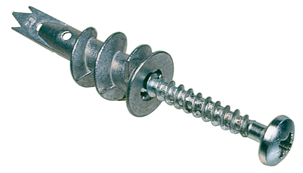

What is the best thing to use to hang a coat hook rack thing on the wall, where the plasterboard is of dubious quality and the batons behind it aren't nearby? Have tried those self drill things, but the ripped straight out.

see if you can get a small pack of these at your nearest hardware shop
[img] http://s7g3.scene7.com/is/image/ae235?$p$&layer=0&size=281,281&layer=1&size=281,281&src=ae235/11923_P [/img]

I've used spring toggle but you have to make a good old hole to get the thing into the all in the first place (EDIT: or did we just bash em through the plaster, I forget), hollow wall anchors might be a better alternative.
Not used either on 'dodgy' plaster board though.
If at all possible, use a bigger bit of wood to get decent anchor on the battons and then attach you coat rack ontop of that...
Dunno about your household but our coat rack(s) are well over subscribed.
EDIT: Tried some of those Stoner posted, and thought em rubbish, but thats only my opinion.
Posted : 13/02/2012 11:36 am
Stoner - those are what I've been using.

Is the plasterboard crumbling and not supporting the bolt, or is the anchor pulling through?
Posted : 13/02/2012 11:40 am
Stoner - a bit of both.
