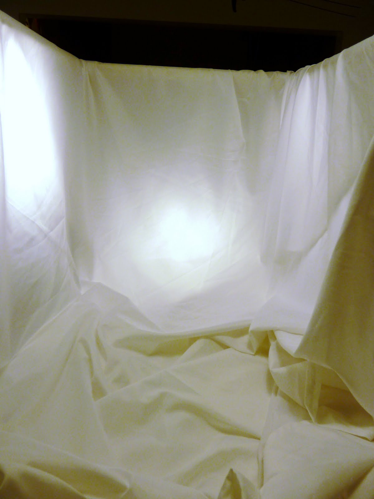

Posts: 91205
Something like this:
Posted : 15/10/2015 12:05 pm
