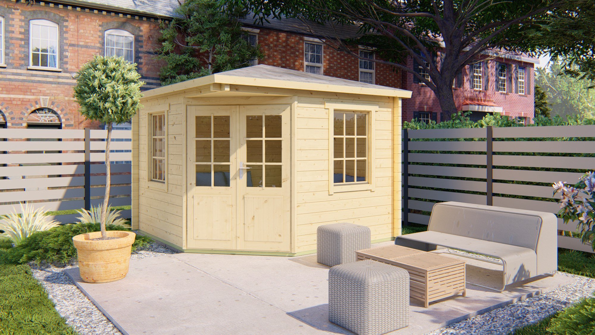

We bought a Tuin one last year, and I've been happily working in it for over 12 months.
We did add some insulation to floor and ceiling, we bought the thickest walls (58mm from memory) and an oil-filled radiator on a timer sorts the winters out.
This one: https://www.tuin.co.uk/Riina-corner-log-cabin.html

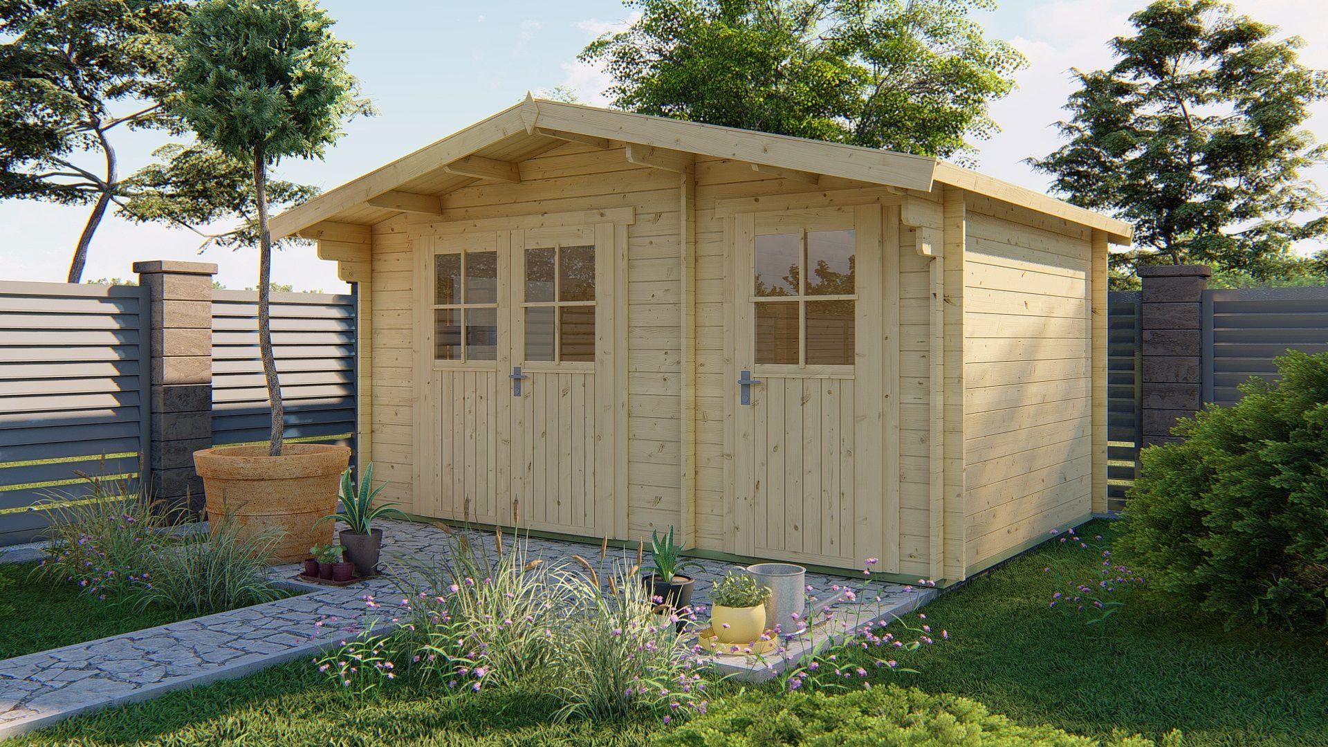

Just finished one from Tuin - this one: https://www.tuin.co.uk/Lukas-Log-Cabin-4.5x3m.html
When it turned up I had to open it and move it into the garden and then do my best to rewrap. That took something like 4 hours...then it proceeded to piss with rain for 5 weeks and I was unable to get cracking. despite loads of tarps and the orginial packing some of the timbers warped which made building a bit of a pain.
I built in the pouring rain as I needed to get cracking - on a concrete pad with a 1cm drop in the corner - and yes this did make a difference to the build, and I have a small gap at roof level and was slightly out of square. Check you pad properly before you start. I thought it was level, but the fencepost i was using to check with a level wasn't straight! doh!
Building took about 2 days on my own. I put DPM under the first logs and then a vapour barrier on the concrete, followed by 30mm kingspan and loft board with carpet tiles on top.
Preserving and painting took forever, and cost way more than I expected - think I spent nearly £400 on sandolin superdec. You have to wait between coats or stuff sticks together - doors and windows needed 3 coats.
I didn't bother with roof insulation as I don't plan to use in winter - the floor insulation was to stop damp. I was concerned adding roof insulation on top of the roof boards would have taken it above 2.5m
They say you don't need to seal around windows, you do. First biblical storm and I had a wet cabin by the windows and doors - took me ages to find the leak as it was coming through the door at the windows
Had a broken handle and a bit of the storm kit missing Tuin sorted it within a couple of days. I would definitely use them again.
So - definitely check your pad is flat, proper flat. if I was to do it again, I would probably have a course of bricks put down to give a level and square base.
Oh and definitely have guttering, amazing the amount of water that comes off the roof.
and finally buy some security screws the hinges just screw in on the outside, anyone with a screw driver can just remove the hinges and the doors will fall out, the same with the cladding around the doors and windows - they need security screws. I bought a bundle from screwfix. Sure they can still just smash a window if they really want but that is a lot noiser than unscrewing some hinges
Posted : 18/11/2021 4:54 pm
