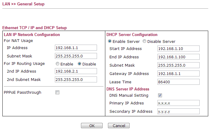

Just to reiterate my OP... I've now got a Draytek Vigor 120 modem, running as a PPoPA to PPoPE bridge to an Asus RT-N66U (Dark Knight) router. Two completely separate devices.
The Vigor acts as a PPoPE bridge, it's not a router, it's a pure ADSL modem. The Asus handles the ISP credentials.
As scaled suggested, I tried hooking the Xbox directly into the modem, which meant I needed to add in my ISP connection details to the network configuration on the xbox. That worked fine. Which I think means the problem lies with my router.
Are the modem and the router both DHCP servers?
There is an option in the Vigor which allows you to disable the DHCP server function of the modem. On the basis that the router is also acting as a DHCP server and since jate suggested that two devices trying to act as DHCP servers could be causing a problem, I deactivated it.
Here is a screen shot of the option on the modem below (not my settings, just a random internet pic)
You need one DHCP server, and any static IPs you assign (why?!) need to be outside the DHCP scope.

It's it cos you've set for manual dns and then not provided any ip's?
Posted : 02/06/2015 9:03 pm
I've got the option "Connect to DNS Server automatically" ticked "yes"?
Posted : 02/06/2015 9:07 pm
But on the router you've not given a dns address?
I'm not an expert, btw.
Posted : 02/06/2015 9:10 pm
