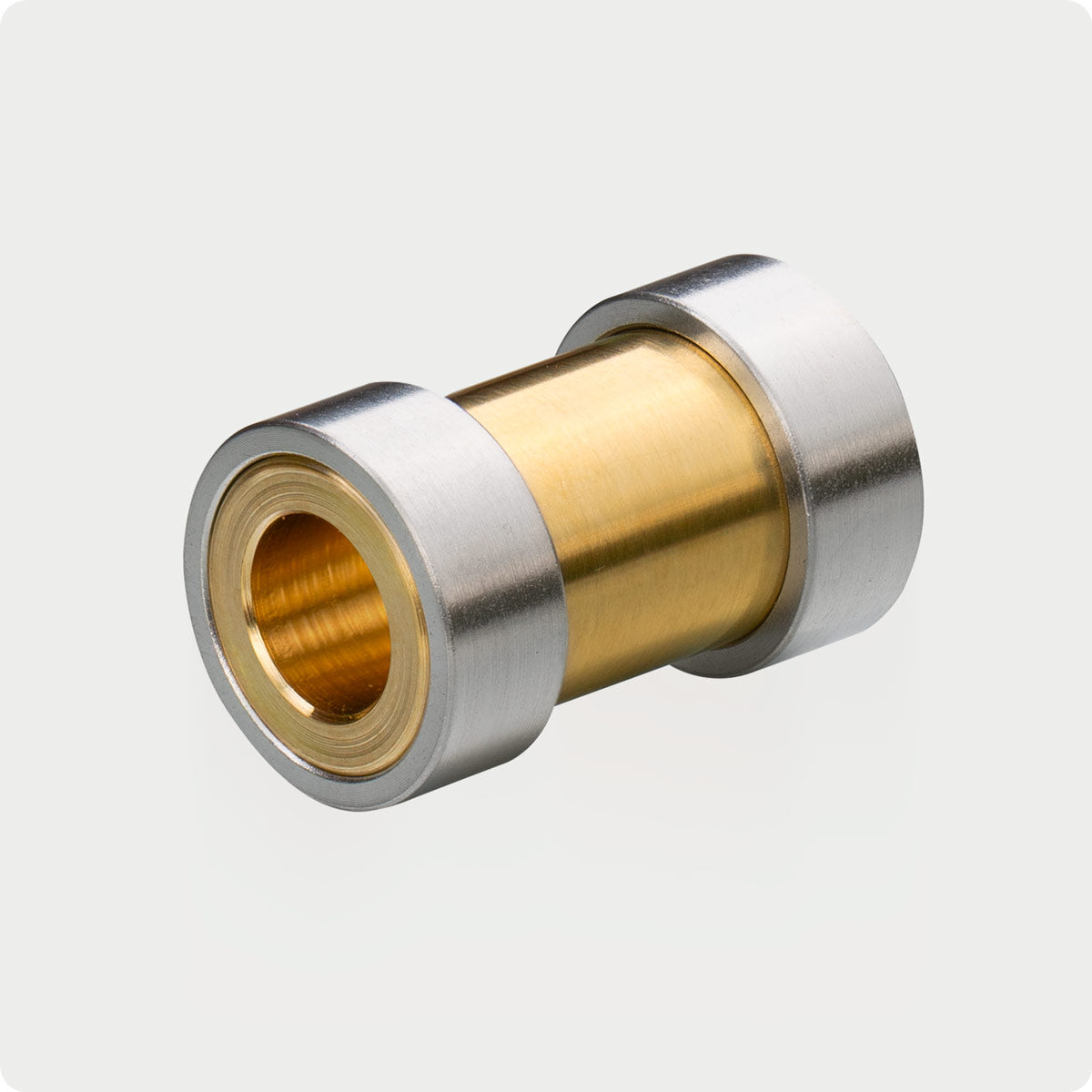

I think you are looking at the reducer, not the actual bushing. The bushing is a thin sleeve that fits internally into the eyelet on the end of the shock, and the reducers push into that. Either one from each side, or a sleeve all the way through, with spacers around it on either side.
The bushing will be either an imperial one or a metric one, I think 1/2 inch or 13mm.
The reducer will be sized to fit this and the inner bore will match the bolt hole in your frame. New reducers will be available from TFtuned.

TW, do u think I'll need the reducers (the silver alu plugs that push in either side) or the actually bushing (sintered tube that presses into the eyelet) or both. Which tend to wear first?

Offset bushings.com are good for this sort of stuff - they do normal ones as well as offset ones. Usually it’s the du/ plastic bush that needs replacing rather than the metal bits in side them.

As Joe says, the DU sleeve presses out with a wee tool, and the you can press a new one in. A wrap of ptfe tape on the reducer can be used as a short term bodge if there is play between the reducer and the bushing.

If you tell them the shock you have and bolt size etc then order this:
https://www.offsetbushings.com/collections/frontpage/products/standard-bushing

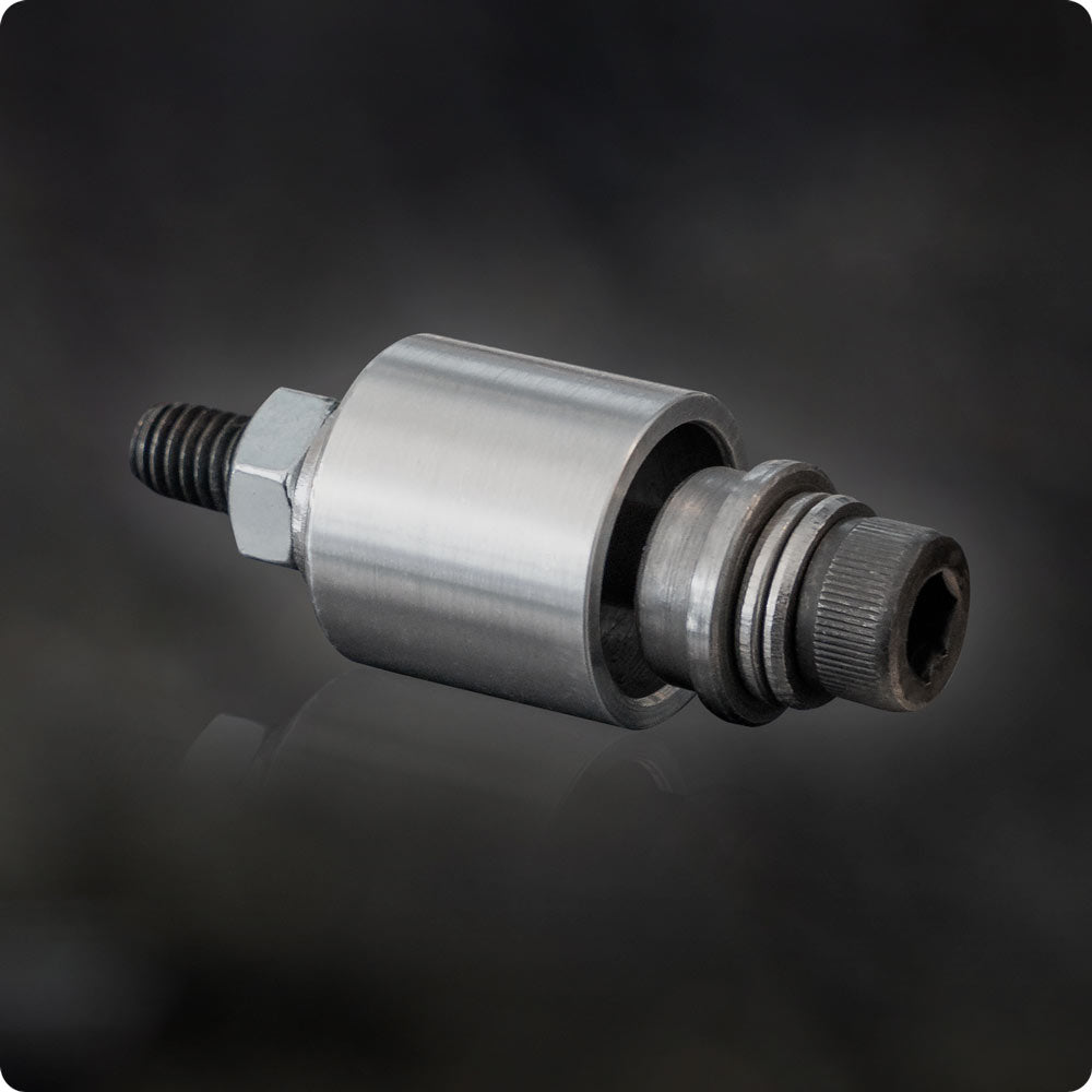

The cheap tool they do works ok for fitting / removing the bush:

Then replacement du bushes are only £2 after that:
https://www.offsetbushings.com/collections/all/products/du-bushing

Offset bushings.com did the trick.
Easy to fit with their tool that's little over a tenner.
Thanks all
