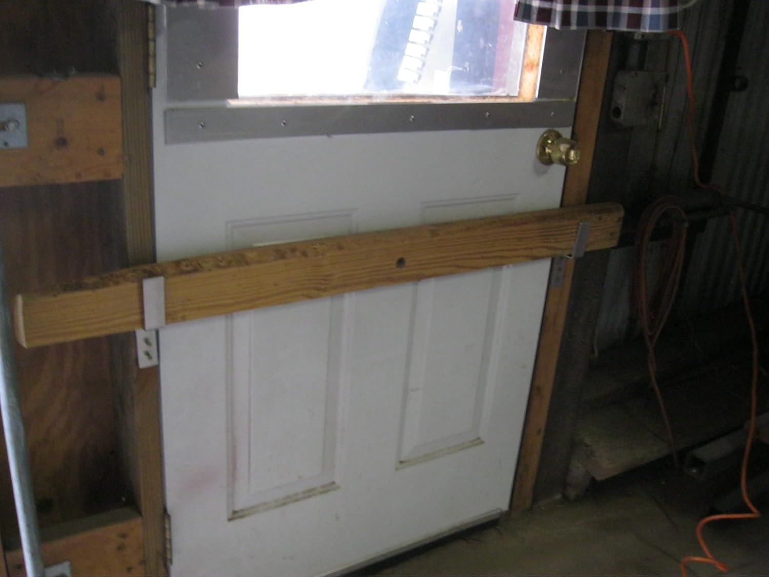

you could use some sort of long wooden bar and holder type arrangement a la old castle door where a wooden bar runs the width of the gates with a drop in holder on each post and on each gate near the centre.
Posted : 11/04/2017 9:56 am
Posts: 21056
This was my thought - something like this basically
You could even hinge it on one side so you don't have to lift it off, just swing it up and secure it in place out of the way.

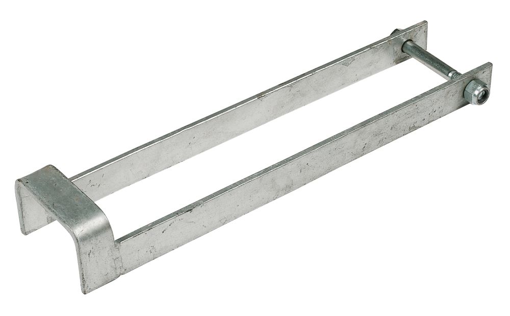

Posts: 10821
Try a throw over gate loop like this. £10 from Screwfix
[img] http://s7g3.scene7.com/is/image//ae235?src=ae235/21124_P&$prodImageMedium$ [/img]
