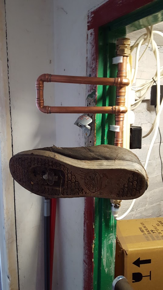

As an alternative to getting shouted at for having muddy shoes on the radiator I designed and built my own shoe dryer.
It comprises a load of copper pipe, 22mm and 15mm joined with Yorkshire fittings (solder ring) and a couple of compression fittings to enable filling and dismantling. You need about 1m 15mm pipe and 200mm 22mm pipe. The heating comes from a 100w heating element for towel radiators and has a uk plug.
I added a variable time countdown timer plug adaptor that allows it to be ran for 15min / 30min/ 1 hour / 2 hour / 4 hour 8 hour.
TBH the heating element is probably a bit big but it was the smallest I could find and only cost £7.50. It cuts out on high temperature but is not variable.
The greatest difficulty I had was finding a way of fitting the element. It is 1/2" BSP that needs to be connected to 22mm pipe. In the end I used a 22mm compression to 3/4" BSP female with a 3/4" to 1/2" female reducer. I've since discovered that you can get straight 22mm compression to 1/2" BSP female fittings but these are a bit specialist and not stocked by screwfix / toolstation/ plumbase/ wickes etc....
You can get 15mm compression to 1/2" female BSP fittings but you would have to enlarge to the 22mm pipe (I wanted a bigger reservoir than the 15mm pipe offered)
I mounted it vertically using 22mm pipe clips screwed into a door frame. Could use a plank of wood and a hook in the wall if no door frame is available.
I'm off for a long weekend biking and will be planning a portable stand to plug in at the B&B shortly.
It dries a pair of completely sodden shoes in about 8 hours.
Costwise: £7.50 heating element, £16.00 for all copper fittings. £2.00 for the plug, plastic clips, PTFE tape = £25.50 + optional timer plug = £7.00. (I Had some spare copper pipe knocking around so it was quite cheap – if you are building a one-off the minimum 2m long lengths you have to buy may make it quite a bit more pricey)
Attached some pics and have plans/ weblinks and shopping list if anyone is interested.

[img] https://tinyurl.com/juxohg3 [/img]
Posted : 17/03/2016 2:19 pm

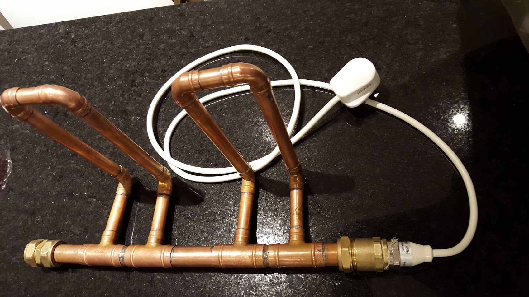

It's working now
[img] https://tinyurl.com/zuwy4l3 [/img]

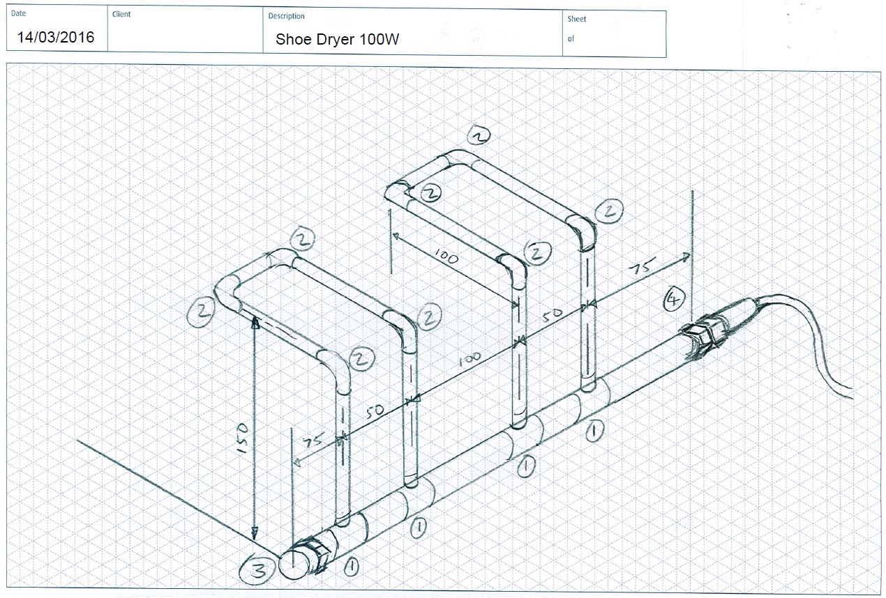

And the plan - although the dimensions have changed slightly.
[img] https://tinyurl.com/hat62yc [/img]

Stato - the water circulates pretty nicely as it is. The 15mm sections are in loops so they circulate well and the heating element extends almost all the way up the 22mm pipe. If I created another loop it would just mean there is more water to heat in the first place so any benefit of a loop would be offset by the need to heat more water and a greater surface area of copper exposed to the air not in the shoe leading to more heat loss.
+ there is more cost in raw materials creating the loop.
A 100w element is massive for less than 1 pint of water. It takes about 10 minutes to feel consistently hot throughout.
A mate suggested I should have put a loop in and a pump. WTF!
Posted : 17/03/2016 2:38 pm

I don't think there is a need for a PRV, doesn't get hot enough to turn to steam and whatever expansion there is (about 4%) will be taken up by the air gap. The copper fittings should be good for about 10 bar.
I'm sure fans would give a minor improvement but the cost would outweigh the benefit.
Posted : 17/03/2016 2:57 pm
I didn't mean an extra loop, more connecting the two loops you have together instead of retuning to the 22mm, so make it one big loop. The heater would cause the warmer water to rise initially so starting a slight flow as cooler water came in the bottom and was warmed by the element to rise pushing more water around the loop etc etc. If it works as is then obv no problem 😛
